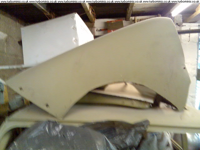

clubminiflip
1840 Posts
Member #: 54
nr coventry
a side pic

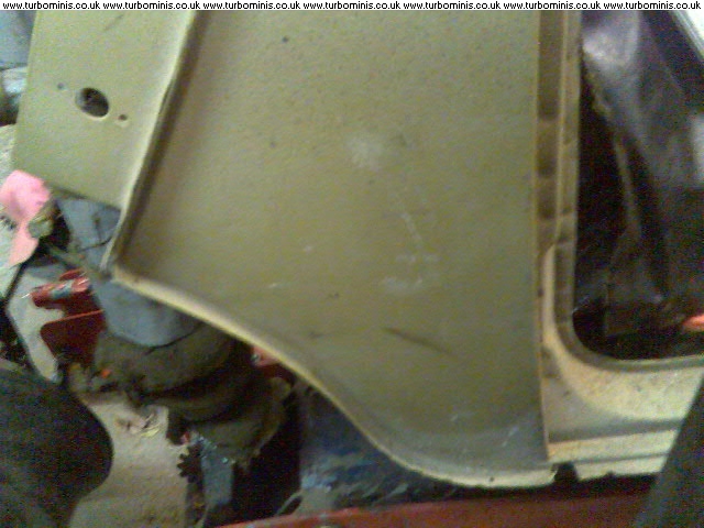

clubminiflip
1840 Posts
Member #: 54
nr coventry
the flange i welded to the a-panal for Dzus fasteners

these are the only pics i have, its just patiants & dont rush & it'll become clear when you have a fiddle on the car, its getting it to fit how you want which is the hard part, i used old strap gate hinges on mine which were sturdy & allowed me to remove the front with no fuss
