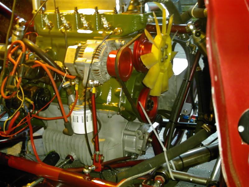

I turned down the boss of my n/d one and fitted a normal mini lucas pulley
6965 Posts
ha ha , see you bust it getting it off too, so did i, lol.
so i made this
http://i24.photobucket.com/albums/c2/carl1...engineincar.jpg.
carl
Edited by fastcarl on 19th Feb, 2007.
9326 Posts
i just used the one off the charade
why is everyone changing them? is it just because they broke when they were pulled off?
6965 Posts
i made mine bigger to slow it dowm,
but it did bend getting it off, [stuck solid]

Like the pulleys, not so sure on the red anodising though!
Jackman
695 Posts
Member #: 984
Westhoughton, Bolton
Yeah i like the pulleys too.
Manchester Minis
It was egg shaped when I got it, then I mangled it more getting it off to take the pictures.
Paul
I think your pulleys look ace carl
