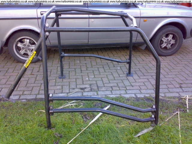

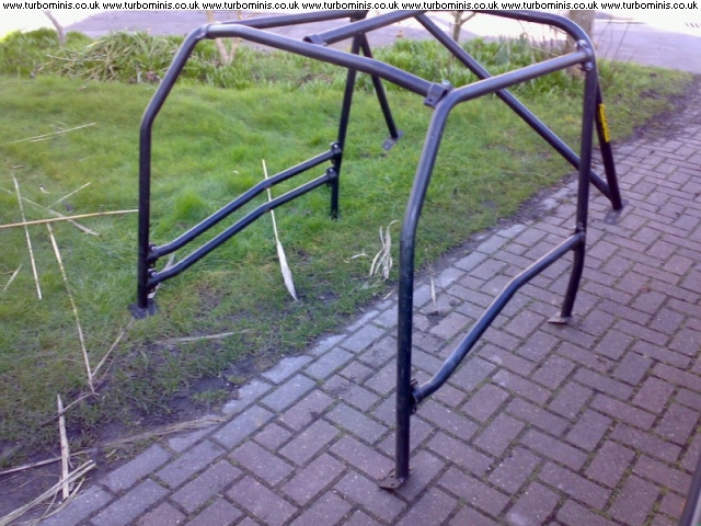

At the weekend i can built my cage in the garden and post pics if you want as the cars a shell at the mo.

yeh some pictures of various cages would be nice, help me decide what it is im after exactly !

AL
549 Posts
Member #: 1347
Croydon (South London)
check out the volv :cool:
that middle roof bar should be on the other way round by the way

AL, what cage is that? looks good, was it alot of £££??

AL
549 Posts
Member #: 1347
To be honest im not sure how much it cost, my mate got it for me (think in the region of £350 new).
Josh. Its a rollcentre cage. The first time i put it in u hadnt cut out the rear pockets and it was a real bitch, my mate ended up losing half the skin off 1 hand. So i cut the things out and now it goes in nice and easy.
As for harness bars they would be extra, or you could put them in yourself, just use CDS steel of correct thickness.
danboy, those are some eagle eyes u got there lol. Im afraid its not my lotus, i went round to a mates to use his camera. Its his dads. He has 2 of them, both elan+2's that red one a purple one (i think it looks like a big dildo) and he has a tr4 in the garage thats hes had since he was 18. Those elans are quite cool tho, handle really nicely. Im not sure but the red one might be for sale in the near future.
