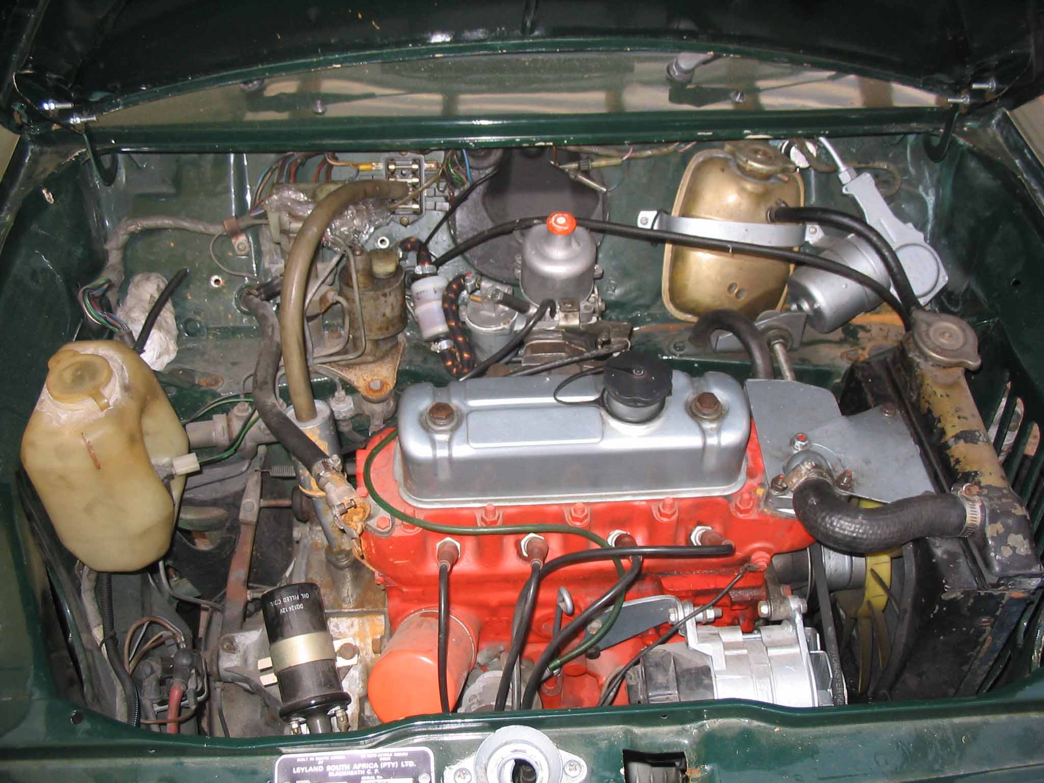

I thought i would just post this pic to confuse everyone.. *tongue*
This block is a South African 1275 block from my last mini i owned.
wtf!!!!
PRE A+ with the filter up top!
CR#
140 Posts
Member #: 1367
Cape Town, South Africa
haha.. dont ask.. I've given up and just accept it.
Typical old South African "boer maak 'n plan" mentality tho.. use whats available.
