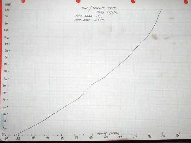

i was doing a bit of number crunching with the acceleration runs ffrom the spud ,and thought it might be interesting to compare the real world graphs with those from a drag analyser software i have
then used the real time graphs to make a more accurate model
this worked well ,so then i thought ,how bout stepping up the hp in steps ,and making a graph of bhp versus terminal speed at the 1/4 mile .
i could use this to guage bhp at the track , ,
this is based on my car with the group 5 arches etc ,so would have a higher drag than some other minis,but i thought it may be interesting to some of the crew on here .
bear in mind that the top end speed is very related to bhp, but will also be affected by weight 60 ft time etc to some degree .
regards
robert.*smiley*
That's very interesting.
Is that bhp at the wheels?
I always used to use the rule that if you multiplied the terminal speed by the ET you should get 1320. So using that rule, the graph also should give a theoretical ET.
I think that because high hp turbo Minis are slow off the line, the ETs are usually a bit higher.
JT

sorry just read it again and its based on your car!
looks good though.

thanks axel yes i thought it was too ,
thats bhp at the crank , and it prob wont necessarily compare with the rr results all the time , i know that when i was testing cars on the rr sometimes just closing the bonnet would drop a fair few bhp .so at the track with bonnets shut and higher temp it all combines to give a lower figure sometimes ,unless of course all that has been programmed into the rr software and its testing situation is similar to the track bonnet shut etc .
hmm very intriging
what do you think causes the slight spike at 100mph?
i crossed at 106mph, and the car was rr'ed on peter baldwins at 188 at 14psi, though i was running 18psi at avon.
Ive noticed that each psi seems to give an 11 banana increase. However i was running low compression on one cylinder at avon (this happened after the rr), so im not sure how much difference that would have made
also baldwins rollers are a bit high
though this looks like it could be somewhere near right fomr my experience
i put that down to a operator error nic !! *blush*
Very interesting. I cross at a shade under 100mph and have circa 140banans.
So looks reasonable.
