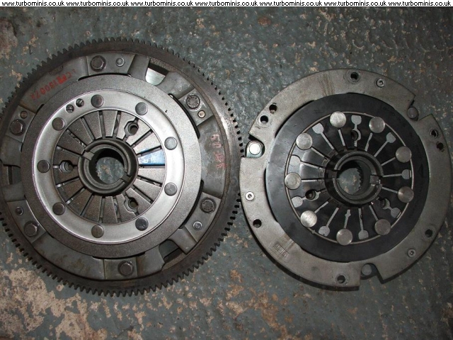

I have been running An injection clutch in the 1400. Recently the springs in the friction plate have started to complain, so I bought the AP racing plate. I had on the shelf a Turbo Verto pressure plate, so I thought id swap everything over, as the engine output is getting larger with all the extra mods.

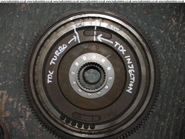

For those that dont already know, it will concern those who run injection engines and wish to uprate the clutch. There is a difference in location of the pressure plate on the flywheel and if nothing is done to recify this before puting the flywheel back on the engine, the SPi engine just wont start, and the MPi engine will start but not much else.
It is a matter of removing the reluctor, moving it to coincide with TCD of the assembled turbo clutch.
I have heard this a few times, people with issues getting the engine to start or run properly, after asking the question the clutch had been replaced, and as far as I could work out, they were not injection pressure plates.
Here is a picture of the two side by side and orientated the same. You can see where the key in the taper boss is at a different angle. After i had marked up TDC on the assembled turbo/ flywheel in relation to the crank sensor you can clearly see the difference in crank angle. Note, I did actualy make a mistake marking the SPi TDC for this picture, it is actualy nearer to the 'A' of the 'advance'. However it is clear that there is a massive difference what ever way you look at it.
The only thing I am a little concerned with is that the Effort required to depress the pedal is actualy less than that of the Injection clutch. Does the Turbo verto have different lever ponts or something or have I fitted anything other than the turbo clutch?? It is a Borg & Beck and is marked Light blue, see in the piccy above. Just going out for a spin to see if everything is hunky dorey. The clutch feel is very different*oh well*
