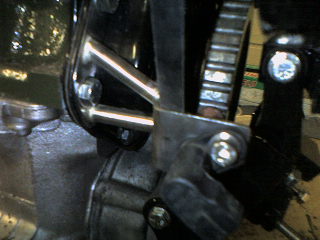

I'm having trouble finding a thread which has the air gap for megajolt VRS, am I correct in thinking it .8mm? if someone could help it would be very appreciated.
Thanks
Shane,
Anything from 0.7 to 1.0mm will be fine.

Nic, VRS meant vr sensor (sorry), I wanted the clearence between the sensor and the trigger wheel, made the bracket this eve and managed to get the to .8mm.
