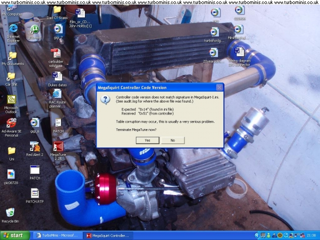

Everytime I try to start up Megatune this appears:
no i know that the MJLJ is connected to COM3, and I know thats what Ive got it set to in comunications...
I dont speak computer, so was hoping someone could tell me what the fuck this means?
(tried searching MSEFI and even google doesnt bring anything up)
If anyone canhelp Id be exremely appreciative
Joe
Edited by joeybaby83 on 3rd Mar, 2007.
I should also mention that if I change it to COM1 or COM2 in COmmunications (but have nothing attached to those ports) the problem goes away, so its definately the MJLJ causing the computer to spit this out...i think...?
i think its something to do with the code variant i should be using, Ive gone into car1 and tried "# set" next to all the different types now but with no sucess..
ive not done anything like this with computers before, all a massive learning curve...
Does anyone know what code variant i should be using?
Its a MJLJ V2....i presumed it would be either MSNEDIS or MSNEDISmod, but neither of these want to play ball?

I though MegaTune was only for MegaSquirt, not Mega Jolt.
This is the config software I'm using:
http://www.autosportlabs.net/index.php?tit...ration_Software
Also for some reason my MJ comes up as being on com port 7, but I'm guessing that's down to my USB adaptor.

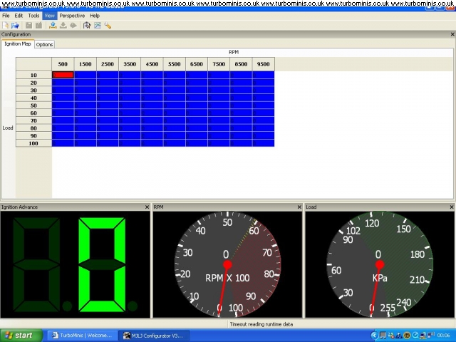

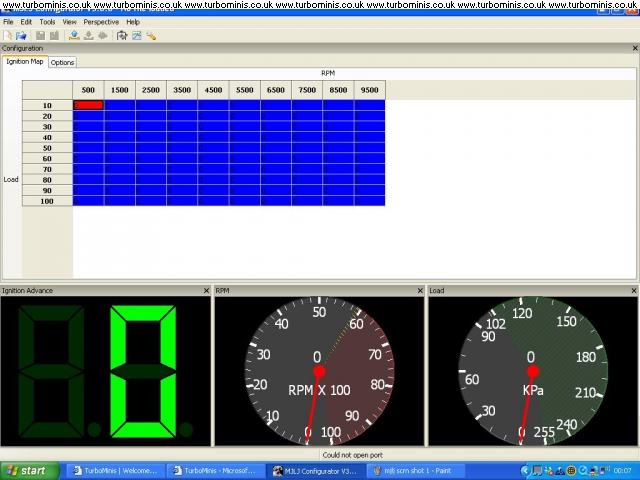

right i think im making porgress
with com3 selected it comes up with:
will all other com# it comes up with:
(im talking about the text at the bottom under the rpm gauge)
i cant find much info about this program, do you think its just problems with the usb adapter im using?

if you update to V3 software on the PC you need to update the ECUs software to the same level. This is called updating the Firmware *happy*
I'll take you through it on messener if ya like :)

Righteo, tried it on a mates pc with a serial cable and hey presto it works (on COM1)!
looks like the usb adapter ive got has got aids, dug my old desktop out of the attic (256 processor dont you know...LOL) today and will see if it still works tonight (if i can find the keyboard).

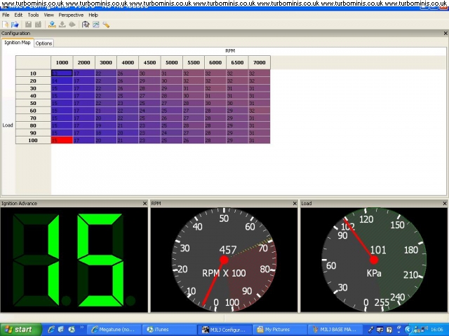

er, just one more question, why is my ecu saying that its 100kPa?
surely it should be reading that high???

thats atmospheric pressure. 100kPa = 1 bar
That is the back ground air pressure (not sure if that's the correct technical term) in a prefect vacuum it will reach 0. So when you're driving off boost the reading will fall bellow 100 (as there's a vacuum) and when you start to come onto boost the reading will go up.

Rob is spot on there *happy*
