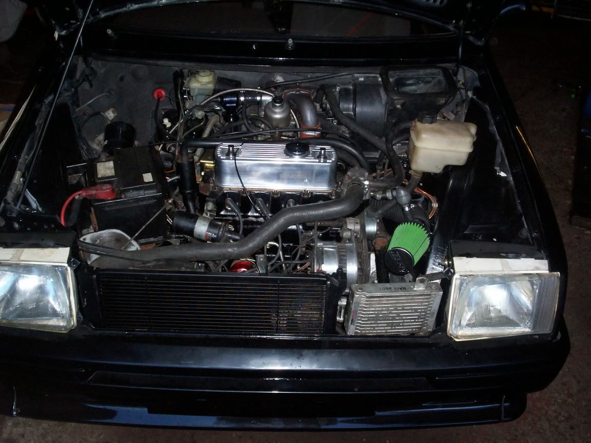

So...after another day in the garage, this afternoon I had the pleasure of driving the car around with my new intercooler fitted *happy*
Top say I am chuffed to bits with the fit/quality/look of my new intercooler setup would be an understatement, I was so excited last night when I started bolting it all in place!
Heres how I did it....

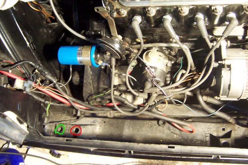

First i drained off the coolant system, so that I could remove the radiator. The radiator sits hard up against the drivers side headlight casing, and I needed to somehow get a hose through there for the outlet of the intercooler. So, simple solution would be to move the radiator a few inches across wouldn't it? Well in theory it's easy, but then the distributor fouls on the radiator fan, and also the oil cooler needs moving.... So it wasn't plain sailing, but I've done it with 4 weeks of patience.
I completely stripped the front end of its bumper, lights etc so that I could get access to the radiator mounting points.
Here is a pic of the drivers side radiator mounting plate, with the original hole outlined in green, and my new hole I made outlined in red. This gives you perspective on how far I shifted it across.

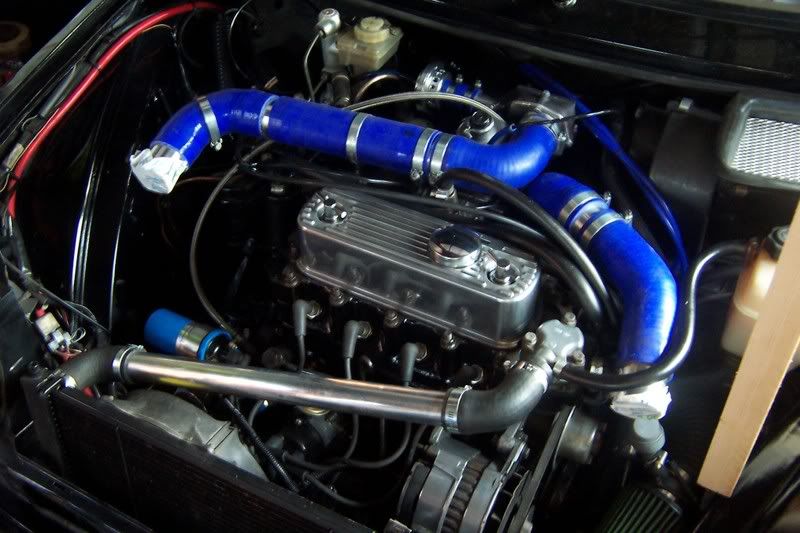

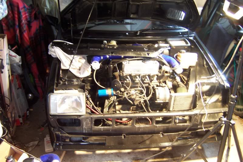

Unfortunately i don't have any shots of the re-wiring/oil cooler relocation work I did, but heres an early shot the naked engine, so you can see how the radiator and oil cooler have been moved...
Before relocation...(this photo was actually taken before my first intercooler install)
After...
If you look in the bottom left hand corner of the photo, you can see that I now have just over 2 inches of clearance between the radiator and the headlight, so I could now get on with sorting out pipework/intercooler dimensions and mountings etc.

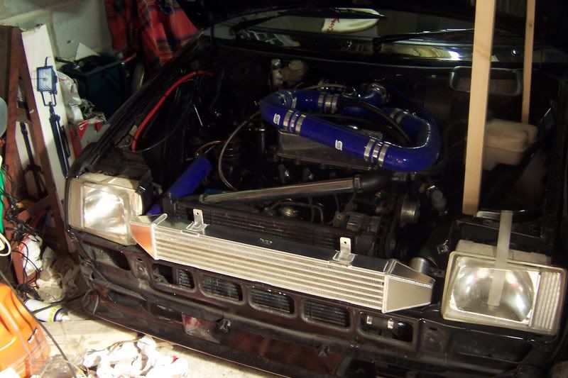

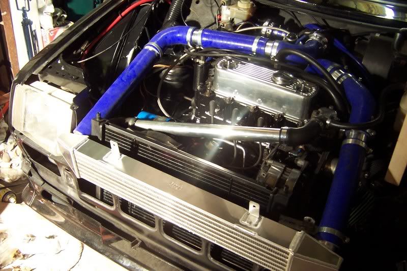

After I had decided on my intercooler design ( a larger version of the 2wd sapphire cosworth item in shape), I made a mock-up and fitted it to the car:

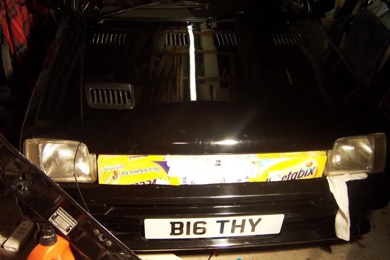

(Note the sock holding my headlight in place :lol: )
I decided that the intercooler needed to replace the grille, so i tried to untilise the grill mounting slots for the intercooler. I also had 2 long tabs welded to the top of the intercooler so that i could bolt it to the slam panel aswell.

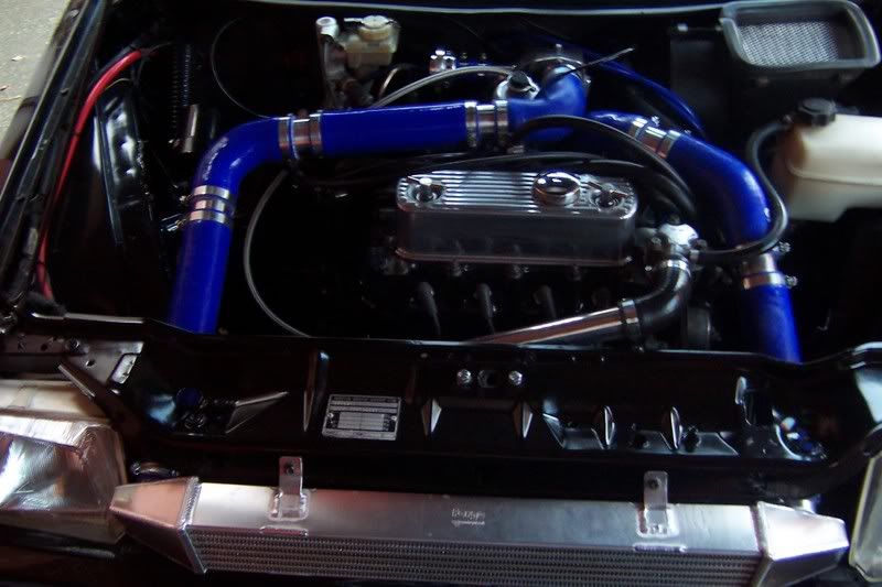

After a 4 week wait I got my new custom intercooler from Forge Motorsport. Very happy with the quality of their i/coolers, the welds are superb and is cooler features an excellent quality core.
Here it is resting in its mounting slots, ready for fitting...
After making up some pipe work to plumb it in, I connected it up and cracked on with securing the i/cooler to the shell...

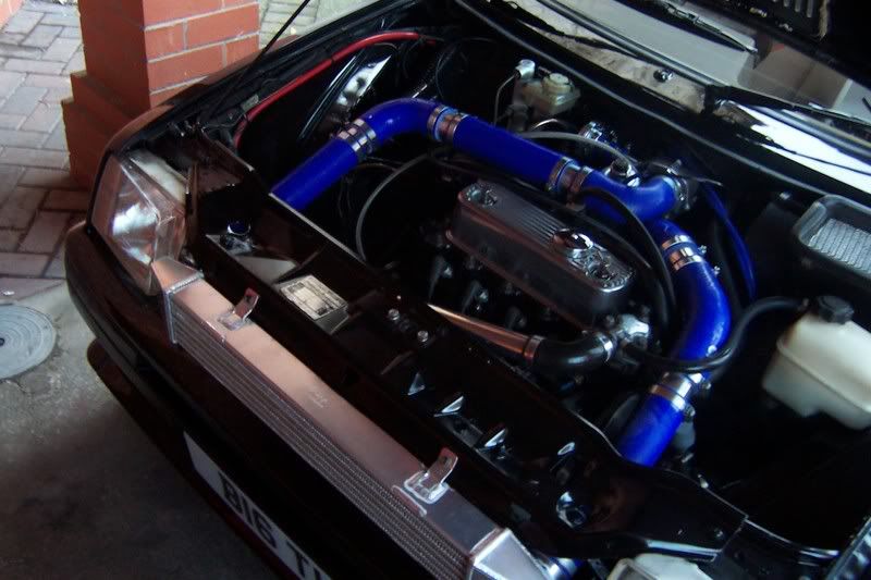

SO...heres my end result after my work, hope you like the finished conversion, I know i'm very pleased B)

It would of been nice to keep the front looking subtle, but the intercooler core is about three times as thick as the grille, so theres no way of hiding it....Unless I drive around with a blanket on top?? *tongue*
