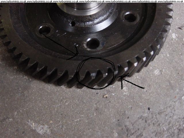

i was wondering if i can savely use this diff. it's a 2.95 and one tooth is slightly dameged.
you're opinions please:)

looks ok to me

i,m looking for a replacement diff for the turbo engine.
so a 3.1 or 2.95 have my interest. both are not easy to get here so i was interested in this one. would cost me 15 pound but thats alot if the only purpuse would be to hold a candle *frown*
for my engine or as spare it would be fine *happy*

need better pics. But if its only the side of the tooth that is damaged, I wouldnt be that concerned.

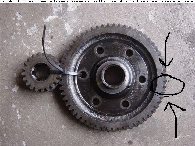

hope this one helps.
it seems that is only the side that is chipped.

id probably use that, as from memory the pinion doesnt go fully accross the crown wheel
(am i sounding a twat, or is that right?)
I'd use that!

Just dress it with a stone in a demel or similar to be sure you have the loose bits off and there are no sgarp edges to form stress raisers.
Totally use it. Get it on a magnaflux to be sure all is well if you want more confidence.

ok then, i got myself a 2.95 diff *happy*
thanx for the reply's
