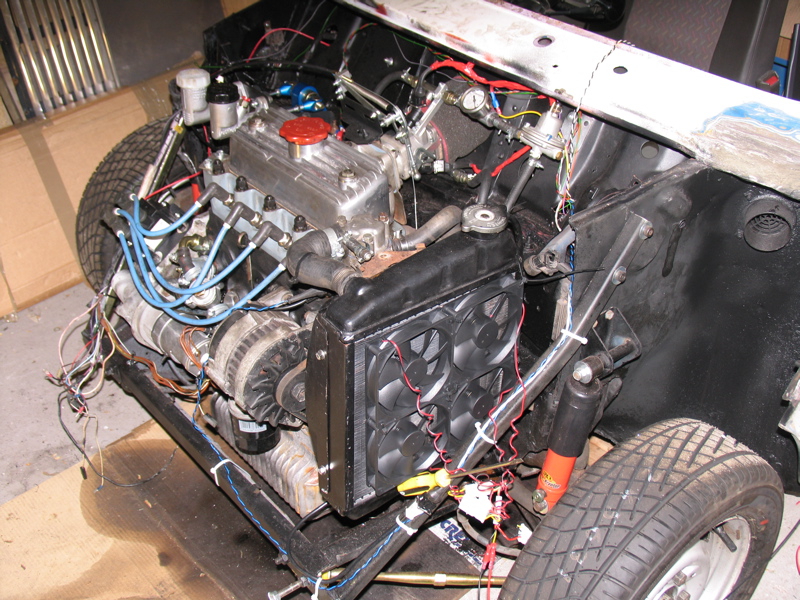

I have the K3 running a Jenvey throttle body as a wet manifold solution. I am not using the MPI injection manifold. I am running NA.
If you look at the pictures on Vmax website there seems to be a throttle body on the inlet so I assume it it the same method, also if you look at his supercharger to cylinder head manifold there are no injection bosses.
This is a picture of mine, basically acting as an electronic SU.
PS ignore the computer fans, a failed experiment, now in the skip *smiley*
