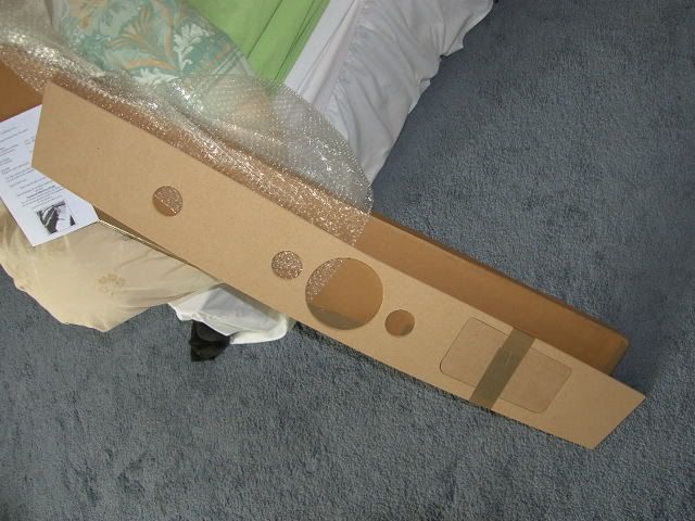

I ordered a custom dashboard from ebay from this shop
http://myworld.ebay.co.uk/mini_interiors
...and its just arrived today. It took a while to arrive, but im very happy with the quality of the cut, and its much better than what i could have done.
The cost was only about £11 and im really happy with that.
I got vinyl from this ebay shop...
http://cgi.ebay.co.uk/ws/eBayISAPI.dll?Vie...96018&rd=1&rd=1
It cost £5 for a 1.5mx1m ammount, which is more than enough.
Im going to begin covering it tomorow and hopefully will have it done really soon!
Ive been keeping miniwilliams waiting for ages now whilst waiting for this dashboard, hopefully when weve forwarded some photos it might be able to get in the magazines :) Really sorry matt ive been waiting for this for ages.

Looks sweet.

So you going to cover the dash with the viny ? :)

yeah, i did it with my last one in the red mini with red vinyl and it looked really smart and factory fitted.
I stretched the vinyl over it and stapled it on the rear.
the bit im not sure about with this dashboard is how to make the glovebox work well, i didnt really want visable hinges :(

You can get hinges that fit flush to the rear face of both dash and glove box.
Good old B&Q sorted me out last time ... so have a look at their range of furniture fixings.

Have you thought about using concealed cabinet hinges? They are what is used on modern kitchen cabinets so you don't see the hinges.

thankyou!! ill take a trip to B&Q and have a look! ill try get the smallest ones i can. I bet there might be some that stop closed too that wont need magnets

The ones I was thinking off are designed for lids on small boxes, they have an over centre action so stay closed. I think they were about £4 pair.
Another simple way is to use a couple of short lengths of webbing strap as a flexible "hinge".
E.g. something like rucksack straps.

you can get piano hinges from any good model shop and it would look and work real nice :) the just put a small catch on the door peice so it holds in place *wink*
feebs may sound daft, but do they do blanks ie i drill my own holes for where i want me clocks, my dash will be yellow leatherette, i dont want glove box etc etc etc ?

yeah! he does them however you want! i wanted my boost guage hole behind the steering wheel so i can see it through the gap, and i also wanted no air vents :)

thats pretty good value really feebs, i like, i want to a dash the same but with my later type 2 dial binicale in the centre, seats are looking ace! your good at this trimming lark!

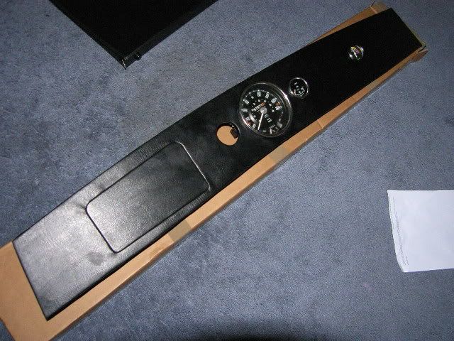

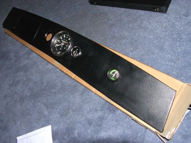

Just covered it! just gotta find where i put my new temp guage ive lost it :(:(

Looks tidy mate.

thankyou! to the other people wanting to do this, i have laods of spare vinyl now, pm me for some :)

Looks very cool, i orderd my dash today :)

dash looks cracking feebs

Great looking dash mate. I've been wondering about what to do with my centre speedo... How much clearance do you have between the speedo and the hole in the bulkhead after the mod for the turbo? Have you had any thoughts about heat transfer through from the engine bay? I'd be interested to hear in how you get on when its installed.
