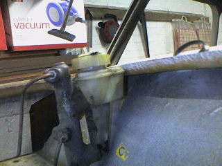

Have been out in the garage again this eve and weighing up which parts under the bonnet of my turbo minus build will pertrude above the bonnet line (as the minus is 3"less in height, and all the parts in the bay affectivly seem higher in reation to bonnet) and found that the master cylinder I was planning to use sits above the bonnet will sit over an inch and a half into the bonnet,
My choices are, fit the original tin can, and convert to sigle line brake system.
Huge bonet bulge (not an option!!!!)

That is the set up I was hoping to use (as per pic), but as its a minus shell, and is 3" less in hieght, (the 3" has been lost in the door skin area, so the gubbins in the bay sits closer to the underside of the bonnet) the master cylinder sits higher than the bonnet, hence me looking for a twin line servo, with remote resevior (that is less in height that the one I ahve) so I dont have to modify the bonnet.
