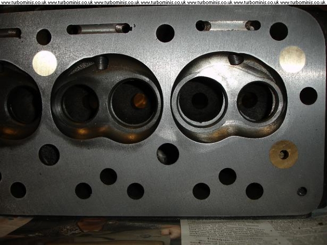

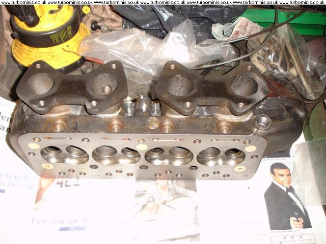

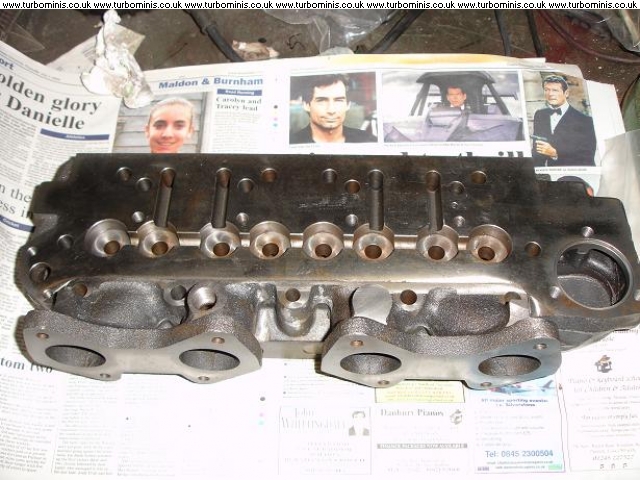

yes all the holes drilled and taped and the faces machined.
hers some pics of mine as it turned up,
Stuart Gurr built my head up for a very reasonable price. It worked out considerably cheaper than buying a built one from Minisport.
