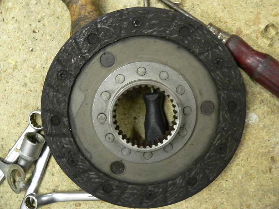

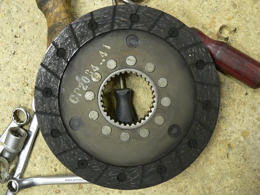

Ive pulled the clutch out last night
the flywheel face looks fucked to me now and the clutch plate on the pressure side has worn to the rivits and the flywheel side not worn a bit
any ideas on what i am doing wrong? plate pressure plate and grey are only 600 miles old
i have new components ready to go in

the plate will wear on the backplate side more, as this is where it takes up.all mine over the years have been like this,
it looks a bit damp , are you getting oil in there, is the plate bone dry, nothing much wrong with the flywheel face for a flywheel thats had some slippage and subsequent heat gone into it,it would still work fine,
the taper looks dodgy though, although unrelated.

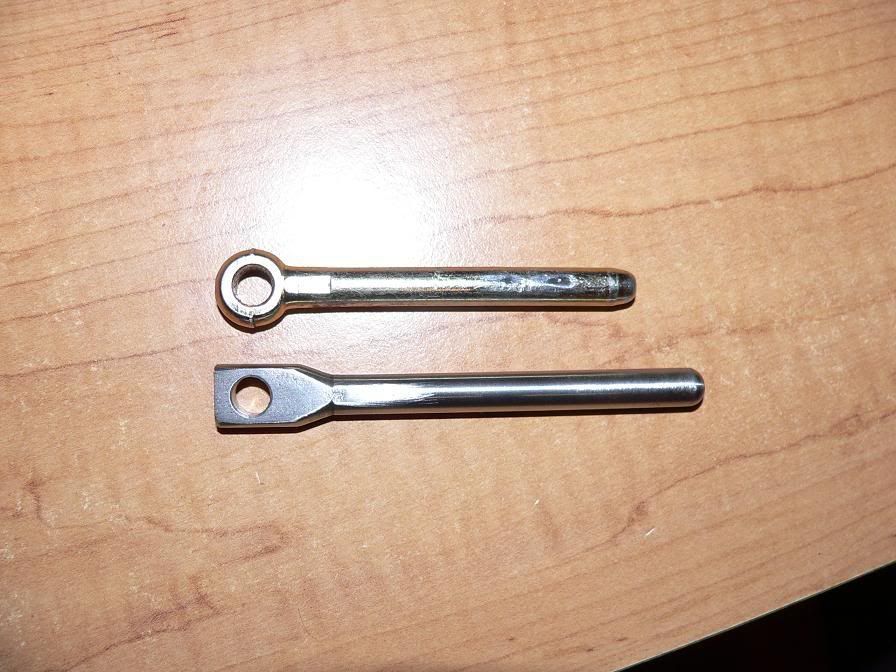

cheers dave you article spurred me on to make this
Chucked it on and it worked first time, i re-bled the clutch and also noticed some black bits in the fluid (never had this before today) i had a spare new master cylinder so changed that as well and am getting slightly better travel now on top of the new pin
thats a nice pin, you should do a batch!!

if you make a batch wolfie i'll take one, got a manifold nut in mine at the minute.
ill make a couple anyway bud, first time ive done anything like this and really enjoyed it
