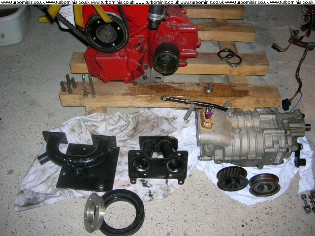

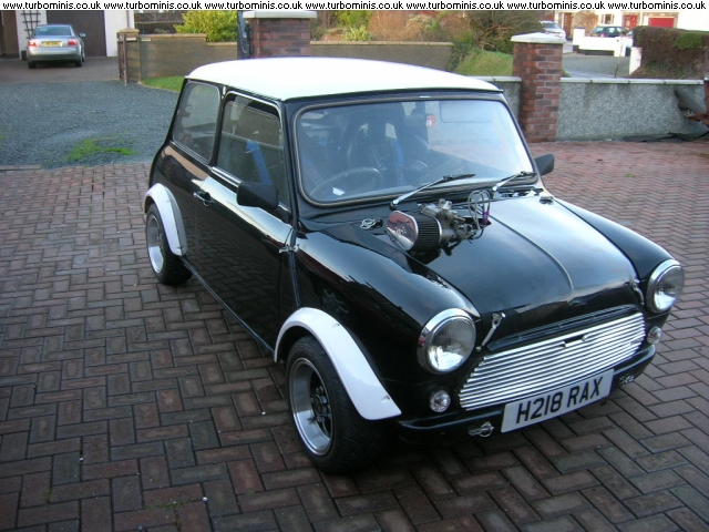

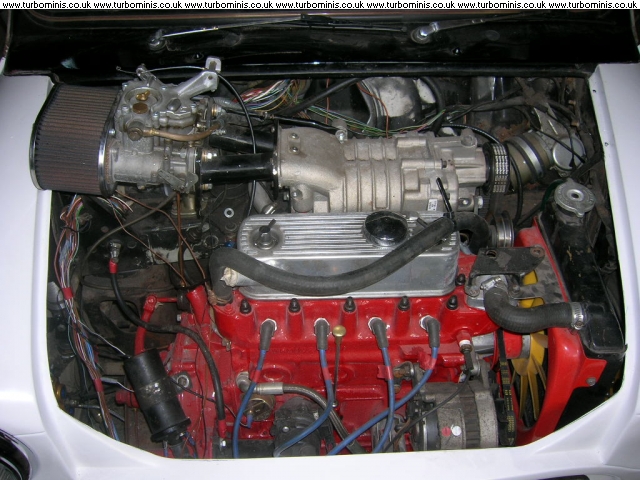

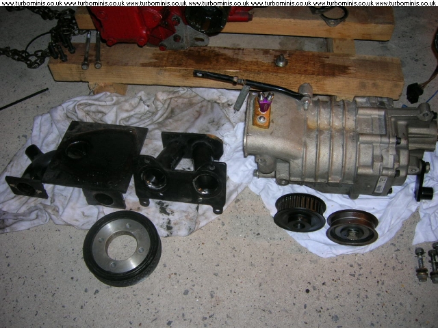

Here's some of mine

Added attachements but they don't seem to have appeared!
mini23
194 Posts
Member #: 1296
Milford Haven Pembrokeshire
ok, lets try this way. Heres a link to my pics on here!
http://www.turbominis.co.uk/index.php?p=14&album=550
Here you go,
cool car by the way, and an interesting solution to the bottom pulley.
mini23
194 Posts
Member #: 1296
The drive belt is an optibelt omega m8 toothed timing belt (they come in loads of sizes, this ones 1120) and the pulleys are readily avaliable if you search google for 'm8 pulleys'
Alex1340
902 Posts
Member #: 111
Loughborough
ok... i NEED more info on how you put all that together and done the bottom pulley. If you got a second please Add me on you MSN, emails is alex.heap@hotmail.com same goes for any one on the site. cheers alex.

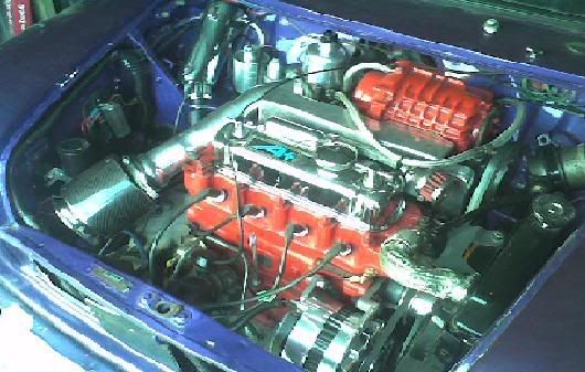

hi guys - new member from new zealand, although ive been reading this site for a long time theres alot of good info on here,
heres my super set up, not a vmax uses a toyota 4agze blower
still a work in progress, hits about 8psi..... now i just need a clutch that will hold it properly
That should be a good set up... isnt that blower a screw type?
crazy1275
34 Posts
Member #: 1634
their a routes type (spelling??) it can handle up to 14 psi i think before it destroys the coating on the rotors, around about 8 with the standard pully, another good thing is it has a magnetic clutch so i can turn it on and off (mad max style)
