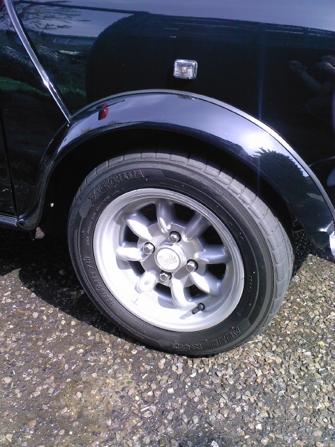

As i said above im running 12's with them, even after removing a fair chunk of metal on the leading edge of the arch they are still very close to the tire, I would even say if I had a new tyre fitted they would foul. At the time when I fitted the arches I was very wary of cuttin too much off the lip as it was a herritage shell and I was pooing myself about fu****g it up, but after the summer having another fettle with them is on my list of jobs.
Shane.
shane
2646 Posts
Member #: 1246
Lowestoft, Suffolk.
when I removed the steel I think i removed upto 3/4" (in places) from the indicator down to the bumper then folded a 3/8" lip on to fix to, in the pic the tyre doesnt look to close but it does nearly touch when going from lock to lock, but this maybe down to my suspension geometry being out, but thats another story / job for later this year.
Shane.
