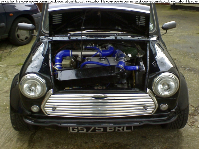

Just wanted to post a few pics of my cars and my intercooler setup.
Thanks to John Flan (the man) for modifying my plenum inlet and turbo outlet pipes. Brilliant work mate!

Nice work, youve done well to squeeze that in.

looks tidy. You have supported the IC haven't you, not obvious from the pics what brackets have been used if any.
It was a total pig! and the pipe that goes over the top of the brake servo was fouling the bonnet. I have adjusted it since then, It now goes up to the bulkhead and around the servo. Doing it like this means that I can even keep my bonnet stay attached.

Yes nice car and nice IC install. Is there much clearance between the IC hose and the bonet on the rad side of the engine? I was going to rotate that end of the IC 90 degrees on mine but yours seems to work as is so I might just copy yours!

looking sweet mate, could i ask where you got your IC hoses from?

The majority of the hoses are from Avonbar. But I bought the two 50mm - 60mm from Zena.
Jay#2 - The Rad side is not a problem. It's the other side that was a pain. I nearly chose to remove the brake servo, but perseverance (hours of swearing) paid off in the end.

Goodo, I was worried about passing the hose over the rocker cover but hey if it fits on yours it will on mine too then.

Jay#2 - It will foul the bonnet if you go over the rocker cover. Mine sits just to the side.

Very nice, a lot to squeeze in but you did it.
