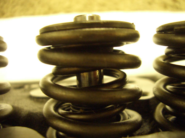

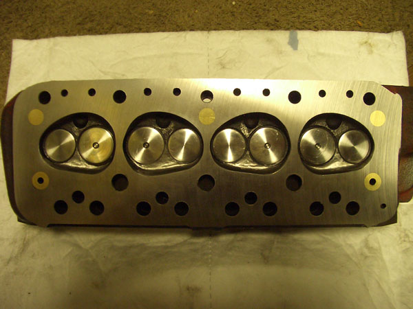

Just got my head back from Steve at Benross Racing!
What can i say... Well, a big thanks first of all.
I can not fault the service that Steve has provided, nor the cost. He has been totally awsome, informative and his work is spot on and speedy.
I'm going to be fitting this at the weekend and hope to have the car RR'ed with Ray in colchester middle of next week. Hopefully it wont make more than 130bhp as my transmission is still all standard (next job on the list though).
Thanks again Steve!

what cc did mr benross get them to?

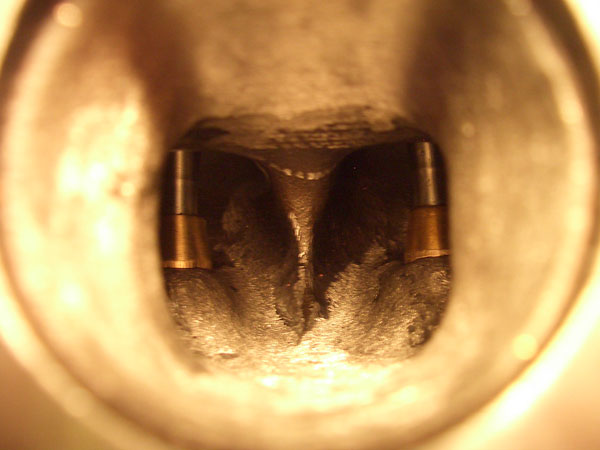

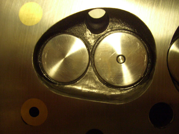

I've just got one tip for Mr Benross. If you remove that little lump outside the valve due to deat grinding, and remove the rough casting in the chambers, the head will breathe better and this will also improve combustion flame fronts. It will also increase the size of the chamber. It's a pig job, as it takes very accurate grinding, but is definately worthwhile.
From this:
To this:
Obviously needs doing before the valve seats are cut.

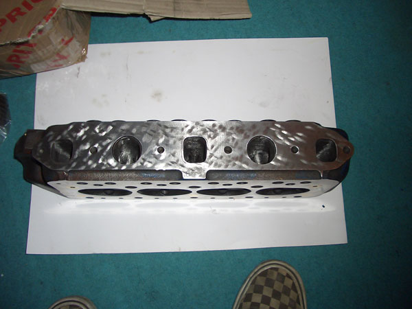

thanks gents, get the drift vegard
for gary i was only going to open the combustion chambers out for him
when i examined the head the guides were goosed and the springs were goosed so i fitted new ones and re lapped the valves in for him
i thought while i was at it i would through him in a little port work in for free! which i did hence the guid bosses have not been removed and all the ports cleaned un
i just removed some bottle necks for him, glad you are pleased! Gray
by no means this is not a bling bling head
but will more than do the buisness

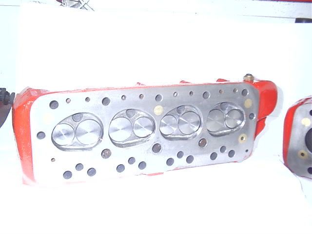

heres a few heads i have on the bench for collection ones for richi my first turbo
Richie
3184 Posts
Member #: 628
Steve ! that looks mint :) and in my eyes deffo a blin bling one lmao :) cant wait to come and get it !!!! dont think it will be this saturday though me wife is kicking off, I been in the spray shop more than i have seen her this week :(
