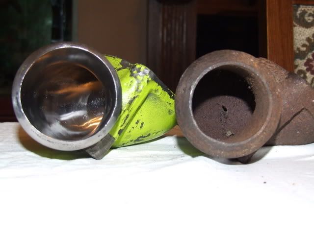

well came back from casa el benross with my new head and ported maniflods, and uprated elbow !!! fantastic work yet again Steve, i have taken some pics of it just to let you see what you get !
Thanks again Steve !!!!
BENROSS item next to stock item

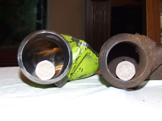

Tried to give you an idea of the amount it has been opened up with the 20p's *wink* i believe mine is 51mm right through !!!!!!

looks great, good work Steve. What kind of power increase should you see from the ported maniflod, and uprated elbow?

to be fair iam not sure, but cosworth used to do this mod before it was known and the mod helped towards a nice bannana count...... i believe the purpose of it is to allow exhaust gases to flow away from the turbo without the gases becoming turbulent and working back towards the turbo (bottleneck) which i have heard in rare cases can stall the turbo......not sure though this info is like 60th hand old.

Wow! thats opened up a fair bit. Does it make a big difference to open that up?
looks like some top work there!
Richie
3184 Posts
Member #: 628
simple answer is yes, so get ure PM into Steve and get it done buddy :)

yes that's a top job!
thanks guys :$
just with the elbow @ 8psi, 9BHP more
with the manifold done and head well a BIG bunch of power *happy*
how much do you want to wind the engine up ???
is this proven or a guestimate. not being funny just wondering thats all

proven !! carl

I can belive 9bhp if it is fitted with a Maniflow down pipe at the same time as the stock Mety down pipe would be a bit restrictive with that done to the elbow, next weekest link and all that.
9bhp is less than 10% which is what most zorst manufactures like to claim for an aftermarket performance system correctly installed.
