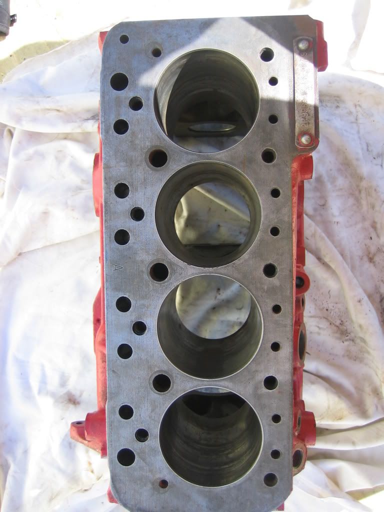

This is the best picture I've got, & it's a bit hard to see the offset factory bore, but I've tried to highlight where the sleeve is at it's thinnest.

Well thats not like the linered A+ blocks i have seen, the ones i saw the liner protruded a good way, I know because i dropped a ratchet in and broke a big chunk off it*frown*

heres some pics of my block, it is at standard bore, also the liners stick out about 2mm proud out the bottom of the cylinders.
