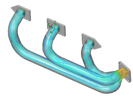

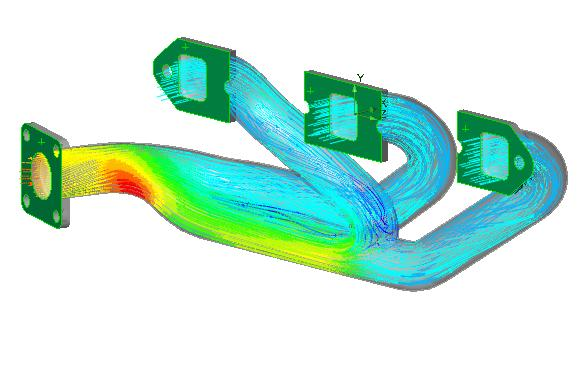

hi again if anyone is interested these are a couple of my current designs, would appreciate any feedback
cheers luke

dout the turbo will fit like that will it? most people have the shaft of the turbo at 90deg to the block.
As Alex says, having the turbo mounted at that angle isn't good. It makes the exhaust point the wrong way and the air inlet point towards the block.
What about cars with servos? Are you planning it to fit these?
Wil

Surely there isn't away of fitting the turbo above the flywheel housing and a break servo, well not the late type servo maybe a remote servo.... would be tricky. put the turbo on top of the bonnet, loads of space there!
It is a bit tight. It may be possible though.
But this is wht the Mirage manifold is such a great design!
