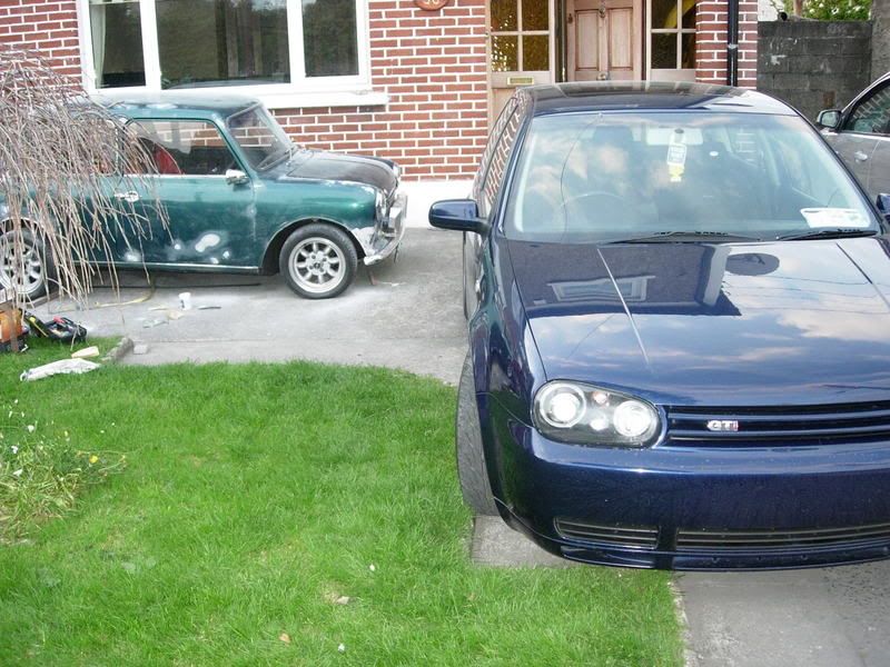

me like a plonker being a pickey idiot I decided to tidy up all the blemishes in the current paint job nothing major of course! but wouldnt you know it when I repaired one blemish I moved onto another and before I knew it I was on course for a full respray
http://i101.photobucket.com/albums/m66/hug...nigolf004-1.jpg
http://i101.photobucket.com/albums/m66/hug...paintjob006.jpg
http://i101.photobucket.com/albums/m66/hug...intjob002-1.jpg
luckily I got the mini over to the garage and booked into the spray booth then I had to fake a few sick days to make sure she was complete... sometimes it has to be done*tongue*
http://i101.photobucket.com/albums/m66/hug...paintjob009.jpg
http://i101.photobucket.com/albums/m66/hug...paintjob001.jpg
anyway got her all prepped myself and in 2pack and left the spraying to my dad
Got her fully sprayed, rebuilt and out to Mondello on time although Thursday night was a late 1...

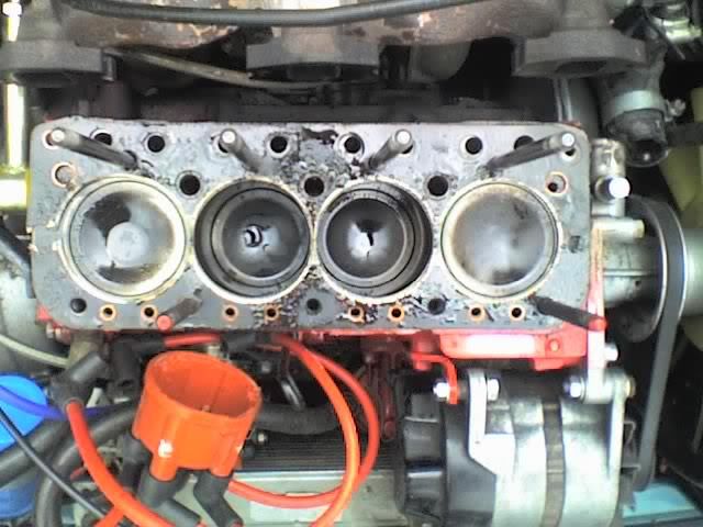

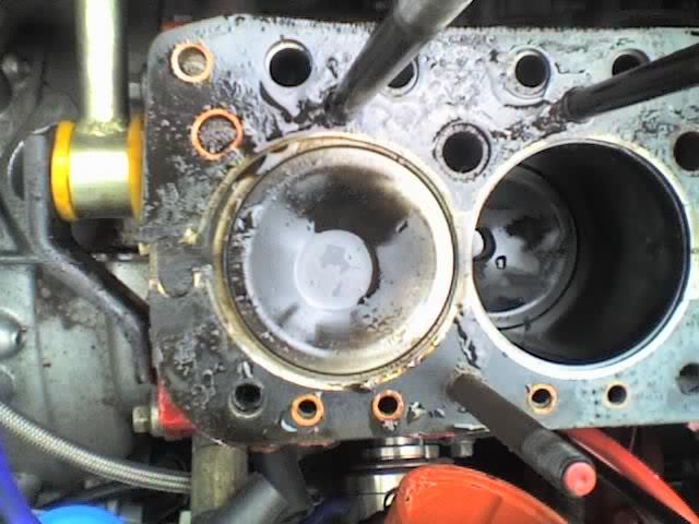

I was a happy camper*happy* but things were going too well and on my second session something wasnt right coming down the home straight so I eased off, luckily 15feet before I pulled in the HG went on cylinder 4, and she started blowing, temp was fine, boost was normal, it just went*frown*
So today its been more work on the mini whip out the head shes off to get skimmed on Monday, I think its a BK451 that most are using from looking at previous posts so Ill be getting one of them ASAP.

Did it blow from number four out to the side? Are you using 11 studs in the head, as mine blew here when only using 9 studs and the head lifted.
Just a thought.

never had a HG fail with 9 studs...

yeah it blew out above the engine steady on 4, and Im using 9studs... Im just about to go lift the had off now!!

anyway heres another pic of the HG
http://i101.photobucket.com/albums/m66/hug...-05-07_1413.jpg
http://i101.photobucket.com/albums/m66/hug...-05-07_1412.jpg
Time to send her off to be skimmed!
rgds, Markie
ooooh! split right through your hole!!
probably worth checking the block is flat while the heads off, maybe countersink the stud holes a bit too.*wink*

Cheers Mini13 Ill make sure to check the block properly*happy*

Never had one blow out the side - in fact the only time i have blown one was into a waterway.
I don't have the 11-studs, but the block is drilled for it. If it ever happens out of the side - I'll drill the head and 11-stud it... Until then - it's 9 all the way.

Dave Im tempted to change to 11studs myself but I might just keep it at the 9 for the moment as Its the first time Ive had 1 go!!
Should have the head back tomorrow evening so Im gona clean down the block and make sure all is well before I start the rebuild,

thats exactly how my head gasket went
it never happened when the block was 11 stud, only with the new 9 stud one
fitted the extra 2 studs and all has been fine since

Dam it!!! last night I was all for going with the 9 studs*tongue*
but now Im really thinking of going for the 11! :(
I think Ill decide later when I get the head back but thanks for the opinions gents
