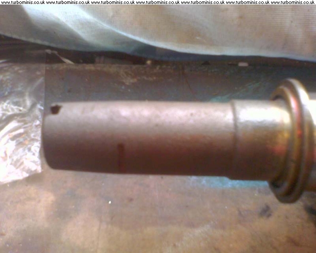

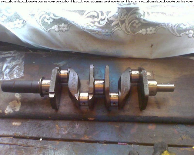

When I got my donor engine, I thought the crankshaft would be f*cked, but I was just after some opinions on the taper end. The rest of the crankshaft is fine and journals just need a regrind.

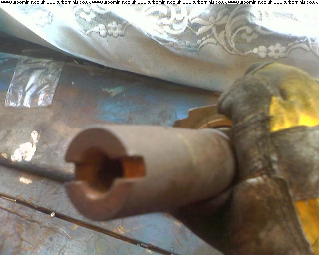

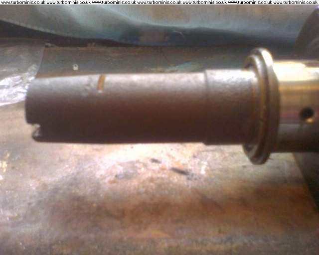

Im just not sure about the taper, theres light surface rust due to the clutch housing being removed.
Just seems a shame to waste a crankshaft
Looks more than light surface rust TBH, but clean it up with emery and see if you can get it back to a decent surface. If not a machine shop will be able to take a few thou off the taper to reclaim it.
I'd worry more about the primary gear journals.
That pitting looks pretty deep to me.

aye true, reckon itll do as a exchange item?

aye it does indeed although surely worth finding a better crank?

lol, well i wasnt planning on using it at first anyway. Reground cranks from minisport seem cheap enough. Just want to make sure they take mine as a exchange item

Clean it up really well before offering it as an exchange item.. specially the primary gear journal, looks unusable to me.
