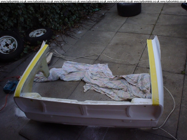

But there is no bracing across the back. What ben did was put some strenghtening olong the bonnet line down the wings, then cut back to this line.
It was a bit of a faf though and the bonnet fitment isn't the best.

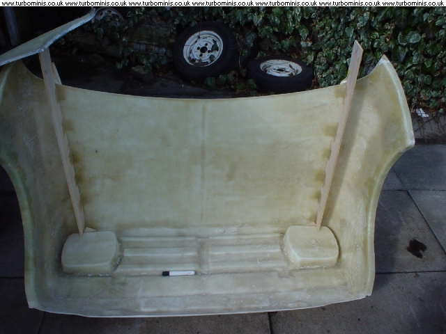

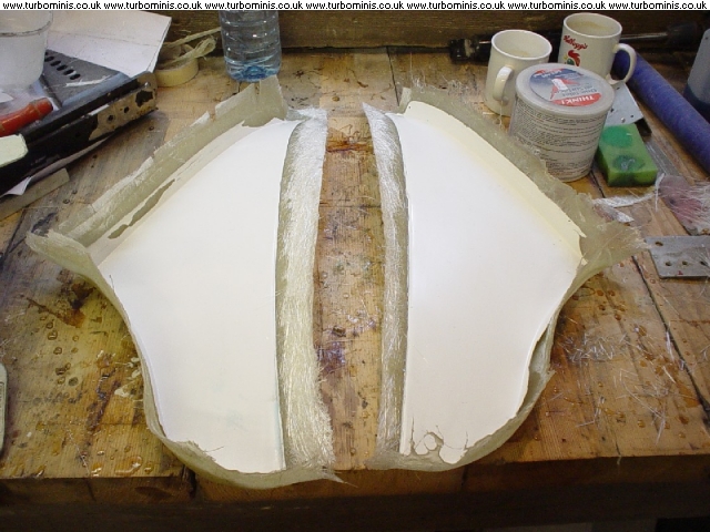

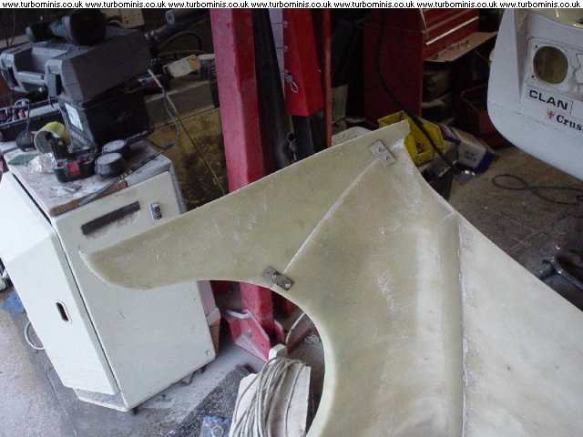

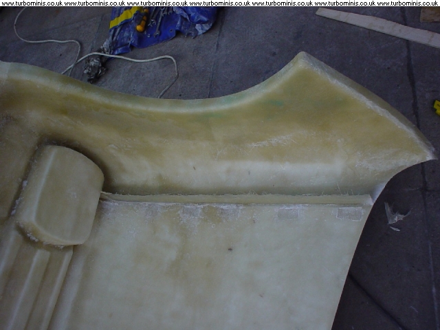

OK this is how I did it. If I had more time I could do a better job, but it is ok. There is no bracing across the back. Orignially I thought I would need some, but once mounted it is solid on the car. It is a bit floppy off the car, but who cares.
Step 1: Put guides along the bonnet lines. (two bits of wood glassed on)
Step 2: Cover the guides with parcel tape, glass up to them and then remove the guides.
Step 3: While all this is going on make a mold for the A panels and then make some glass a panels. (not necesary if you dont want them)
Step 4: Fit the A panels (the metal is to hold them until the glass is on)
Step 5: Cut out the bonnet and trim it all up. (the cut out bonet is scrap and you will obviously need a propper glass bonnet)
We did this because nobody supplied 2 peice clubman fronts at the time, now people do so I would not do it again unless I happened to get a frontend free or already had one.

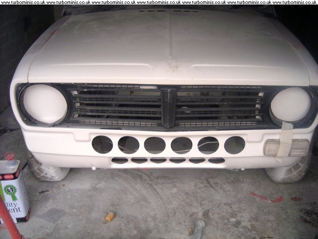

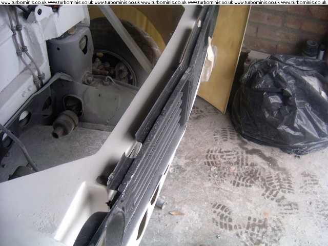

ive just finished fitting my ABS 2 peice fibreglass front.
the original grill fits in no problem.
it has the lower vent shape in, just needs cutting out.
i pretty sure the original clubby bonnet wont fit ill check when i get in.
its the one with built in a panels and its been a real twat to fit. a panels wernt long enough to reach bottom of sill, i had to extend them. the tops of wings were well out of align and needed lots of work. im pretty happy with it now though, but its definatly not a quicjk job to fit.

By looking at the pics Ben supplied you get an idea of what you need to cut out etc.

Big thanks to Ben for supplying the pics thats exactly what i was after! cheers.

heres some pics of mine, it different from the ones in the pics above because it just has a hole rather than a grill moulded in already.
and a pic with a normal bonnet on, its a tiny tiny bit to big i rekon you could get it to fit with a bit of fiddling.

Carl, the 2 piece looks well made, i would go for that option if i hadnt spent hours.. days.. etc getting mine to fit as i wanted it.
