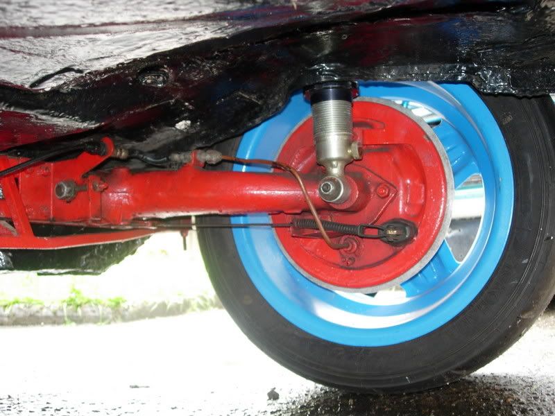

Suspension
Replaced Rear Subframe with Speedex Beam. Fromt and Rear Spax Coil over suspension. Full Adjustable springs, dampers and ride height. Rose Jointed Lower Front Arms and Tie Rods. All adjustable for camber caster toe in and out

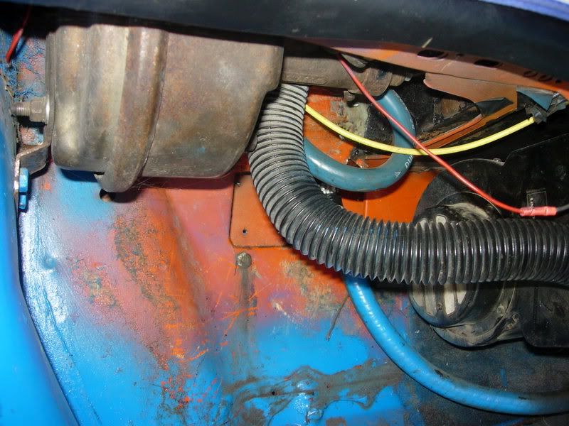

Servo Assisted, Mounted in Car under Near side dash panel. Four Pot Calipers 8.4in Drilled, groved and vented discs. E.C.B Kevlar PAds at the front, Super Minifin Alloy Brake Drums at the rear. Stainless Steel Braided Front Brake Hoses
Heres the Brake servo mounted under the dash!
