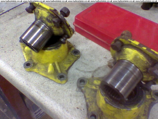

are these any good for a turbo application, are differant shafts needed? i found them in my garage today! they are in ok cond really, no scoring or pitting, just new oil seals, nuts n bolts & a good clean & they should be ok i reckon, cheers all

theyre hardy spicer joints, but not sure those dif covers will be suitable for a rod change box
Minispares sell the diff covers with the proper flange. They're told to be power sapping compared to the pots, but I really like them.
If you buy a new diff cover for a rod box, I'll be interested in one of those *wink*

i dont know when or where i got these joints but if they could be used in a turbo application i'll keep them, i think the driveshafts are differant too are'nt they, i dont have those though!
if they cant be used on a turbo for whatever reason ebay will get them more than likely

They look identical to my dads on his cooper S.
That's because they are the same *wink*
THey use regular old rubber joint driveshafts. Remember that these need special output shafts from the diff as well.

has anyone got pics of this type of shaft fitted/in use! i'm lost on what they are from for! i tell ya its hard being a novice *happy*

There are two three types of diff flange that look like these
1) The pictured ones are Cooper S and some early automatics
2) The automatic only ones have no bolt in the middle and slide on the shaft just like pot joints with an internal circlip
3) LSD ones which again have no bolt but are integral with the splined diff output shaft.
Cooper S ones have a larger outer diameter

well in my hap-hazard fashion i've looked in an issue of "keeping your mini alive" lol *tongue* & i think mine are cooper s shafts, seem to be favoured by the racers apperently!
just have to think what to do with um!
