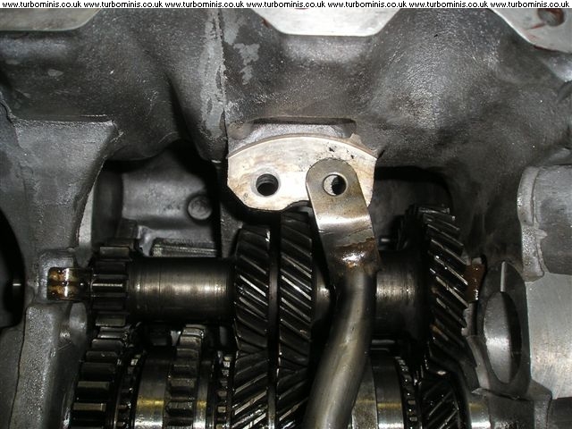

i placed the pick up in the gearbox and saw that that holes did not lin up.
i can bend it into shape and bold it. or lose the tab all together.
what do you think. the way i think is what isn't in the box can't go lose and destroy my geaurbox, in case i bold it.
it's now only bolted with the original 2 bolts and i can't move it. so maybe it's time for the grinder.
what did you do?

Bend it, make sure its not touching anything tho!
