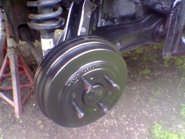

I tape up the rubber hoses wit duct tape, & any areas that are vital to the fuction of the brake, ie the caliper pistons & seals then i use a wire brush attachment on a drill, it brings them up a treat! gotta be the best method other than blasting!
i've just cleaned & painted the drums on my dads rover 414, came up as new, i've done the front calipers but have to get pics of them!!!
rear drums on my dads rover, theres masking taper on the wheelstuds in that pic
