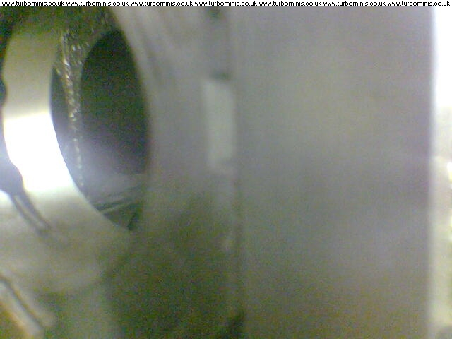

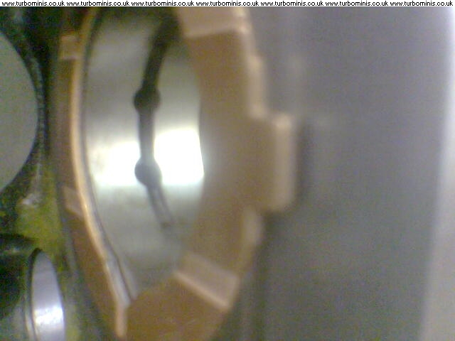

as kindly pointed out by will-h & others my centre mains strap looked a little dubious & is the cause for some concern reguarding the location of my thrusts so here's some pics to show what the craic is:
in this pic you can see the centre mains strap does'nt overhang the sides of the maincap
this is to show the thrusts in place well.........held my me anyhow *happy*
i have 2 centre mains straps, the thinner one fitted & a wider type from minits, the way i see it i could take the main-cap to the machinist & have dowls fitted, or.... use the wider centre mains strap & have a groove machined to help locate the thrust-washers, what do you chaps think i should do, i'm leaning 2wards the wider main-cap with grooves machined in, should'nt take long i dont think, either method????

file the block and use the thrust washer with the locator on the block side instead of on the cap side.
I'm sue Simon had some of the wider straps made with the groove already machined in, give him a call.

I would defo got for the wider strap machined with a slot. If and when you need to replace the thrusts you won't need any machinging to get the dowels fitted to the thrust.
