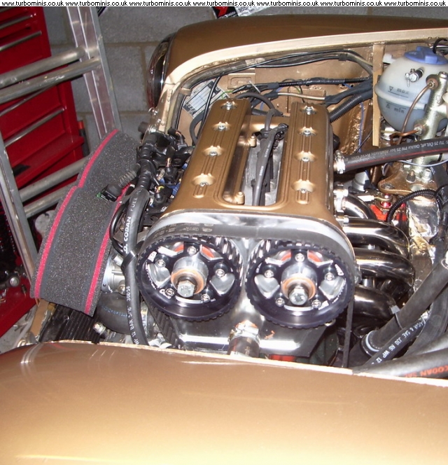

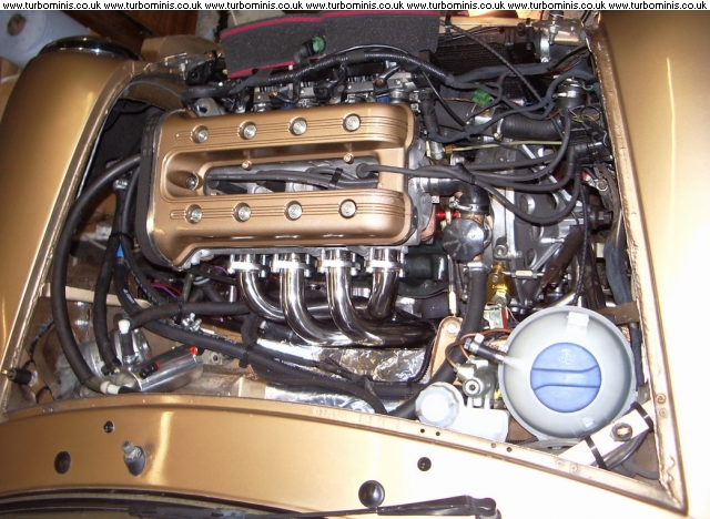

I thought I 'd pop a couple of pics of the gold car up as its complete now after a good few months on axle stands! just need to corner weight it/ 4 wheel alignment and get it on the rollers next Friday, lots of reasons why I'm running later than usual this year but it's in one piece now.

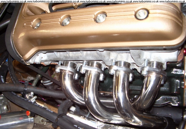

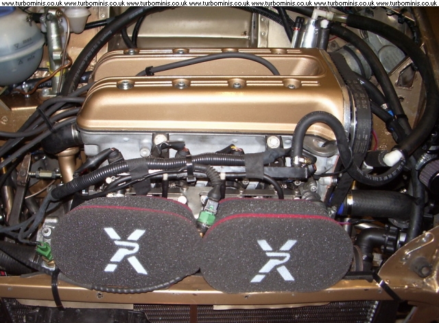

major engine difference this year is running 38mm bore throttle bodies (K1200RS) and the large bore 4 branch.

exhaust is very tasty indeed!

What happened to the 4-1 bananas?

mini13- the 4:1 is sitting on my wall - I need to see what the 4:2:1 will do for torque on the race cams, the 4:1 produced the beans but the torque/power curve was sensitive to the tuned length of the primaries - went through a "resonance" every 1000rpm or so, you couldn't feel it but I'd like to get it smoother and higher! - so will see how the 4:2:1 handles the gas from the big boy!

Looking vary good, if a little sparse without that manifold
Whats that thing on your clutch? the linkage thing?? does it make the feel any lighter?

Nic - the thing on the clutch is a direct action linkage from SH Engineering - the pedal efforts are similar to hydraulic but it is ultra reliable and will not "go off" like the hydraulic one used to (engine is solid mounted so the clutch pedal doesn't wander!)

Looks wicked. It'll be interesting to see what difference the 38mm TB's make. Ive just bought myself a set. :)

Nice Pipes
