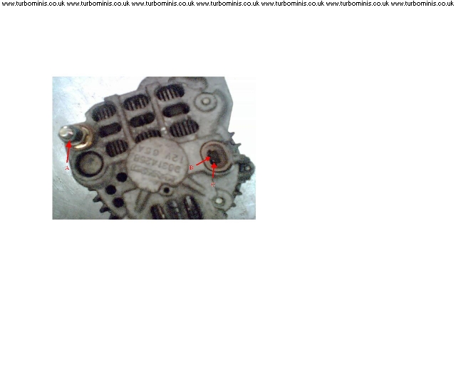

Hi could anyone enligten me as to how to wire the above alternator big brown to post on matiz what goes wher on the two pin plug,

Hold the alternator so the threaded connection is at about 8.00 O.clock and the 2 pin connection at 1.00 O.clock
The thin brn/yel goes to the left pin of the 2 together. (charge light I think)
The thin brn and large brn/yel goes to large threaded connection.
The pin on the right of the two is unused.
Found this *wink*
A) thick brn/yel and thin brown
B) Thin brn/yel
C)Unused
*wink*
