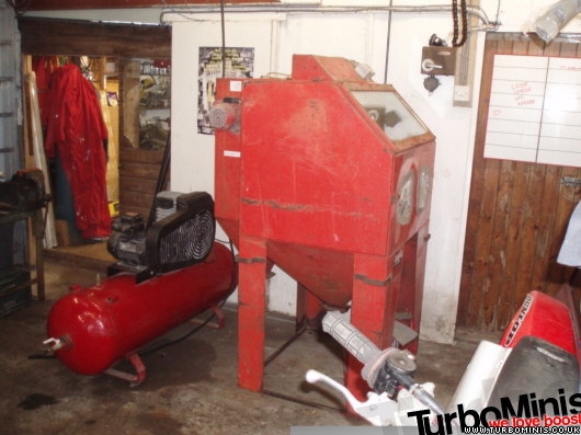

getting a hug mofo of a sandblasting cabinet delivered tomorrow, and doing a bit of research as to what to use
from the various threads on here it seems actual sand (i.e playpen/silver) is a big no no due to health concerns
i know there are other options avilable, been offered a few buckets of powdered glass by a mate, but my old man thinks this isnt wise to use either?
is aluminium oxide the way forward then or what? not too fussed about cost as its got a big as hopper in the base to recycle the medium if need be
anyone seen that soda blasting thing on frost? was gonna buy one till this came up, any experiences with it?
What a beast
r1_manx having a 'blast' hoho
currently got steel shot in, worked like a dream on a rocker cover, also got a few buckets of powdered glass on the way for ali etc

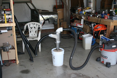

I wound up making a cyclone to try and separate the fine blasting dust before it gets to the hepa filter in the shop vac. It actually works pretty good... very little makes it past the cyclone.
