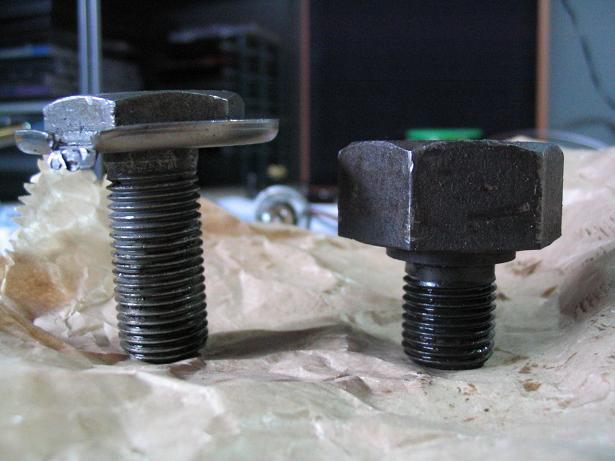

Erm, ok, should of thought of this earlier....
They are the same size....
So, I had a look at a spare fly wheel bolt. Pully bolt on the right, flywheel on the left, it's much longer, easily long enough for what i want!
Job done I think, unless someone can think of a reason I can't use it on the other end, it screws in and that fine.
Nick
4828 Posts
Member #: 154
Midlands
can't see any issues with it, i'd use a dab of threadlock to be safe though.
chrisls
5 Posts
Member #: 1837
Good call, might be an idea. I'll check it as well, at least for a while. And to check other things down there like weather the crank sensor has stayed in position.
graemec
940 Posts
Member #: 1424
Carnforth, Lancs
Yep, dab of good locktite as you won't get a tock tab to work too well.
Also make sure it nips down and doesn't bottom out in the end of the crank and just 'appear' tight. Try it without a washer first and if it screws up then stick a washer in and you know it won't bottom out.
