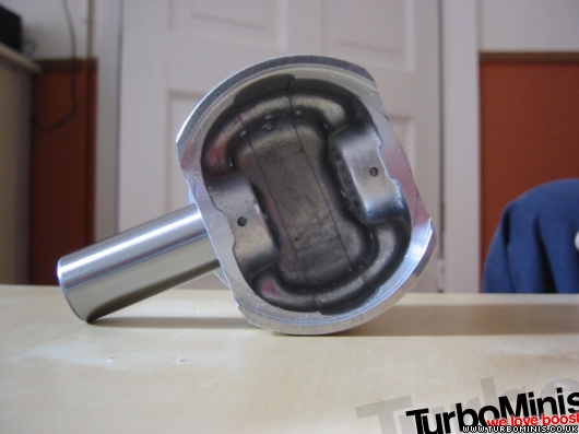

just got a 998 set and a 1275 set in (5 days from Oz to here.. 14 days for customs to figure out how much VAT they where going to charge me)
the larger sizes are the ones without the slots.
1275 +96/73mm:
998 +120 ! :
Edited by Sir Yun on 19th May, 2008.

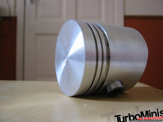

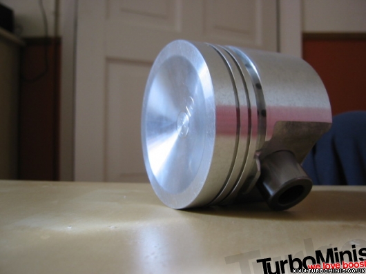

I bought a set (73mm) from Minisport Australia (through this site, he advertises in the "for Sale" section).
Also the larger ones without slots...

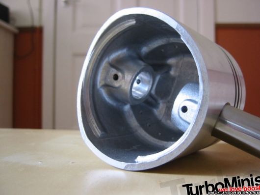

I will be using with turbo (but my project is taking far too long) but I haven't yet decided how much I dare machine out of their current dish, they only have 7.6cc as standard.
They need enlarging slightly otherwise I'll have to take enourmous amounts out of the head.
They look thick enough in the crown to have a fair amount machined out but the underside is a bit of a strange profile.
I also got them at a VERY good price - UK customs managed to ignore them and they came through with no extra UK duty/VAT (sometimes you get lucky!).
I guess the only way to tell is to cross section one and see how thick the crown is! *oh well*

I've gone for the cheaper option..... I've depth gauged it from top and bottom and mapped the thickness.
Borrowing SirYun's photo, the areas it will go thin if I machine the profile I want is here.
They are 6.5mm to start in the centre, I don't want to go below 5mm in the centre, but with a shallow "U" profile (to get the maximum volume with 5mm in the middle) I'll be down to 3mm in those two very localised areas.
So I'm still undecided.
