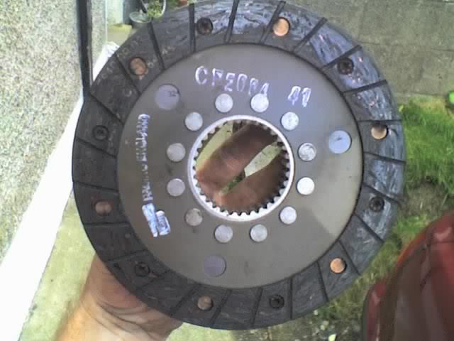

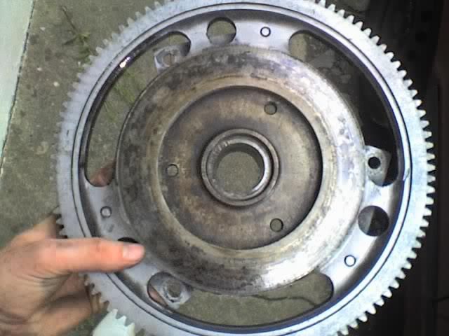

Well I finally got round to stripping my clutch down today.. been havin a couple of issues with full engagement of gears so I needed to go and have a look see..
So I checked the usual.. Master and slave cylinder and both are fine...
Proceeded to strip the clutch in Flywheel out and all appeared ok?*indifferent* faace of the flywkeel was a bit worn.. but couldnt be the answer to the problem I was having
I was only about to post a thread for a bit of help from trusty old TM when stripping down the bell housing I found this!
The little bugger*surprised*...
Any body else had this problem?

Looking at you clutch plate it looks a bit like one i took out recently. the outer part of the friction material has worn as you would expect but the inner part is like new. mine had done a couple of thousand miles so had a bit more wear.
still no idea why though.
the MS one i bought seems to be a bit more heavy duty than the std ones i've seen, course it could just be the std ones were all worn away...
