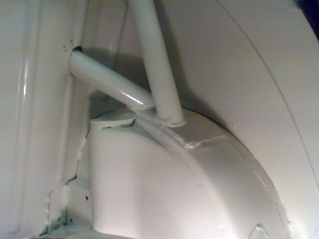

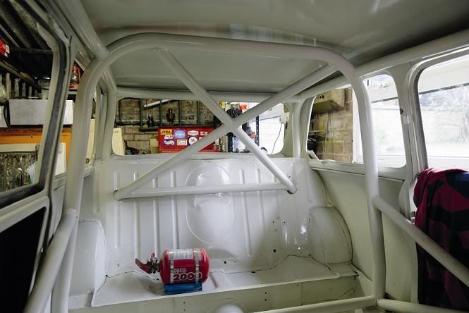

has any one got pictures of any of the miglias, particuarly of the inside/rollcage?
i need some rough starting points for my cage.
Here's one built by Bill Richards with a Rollcentre cage:
The article was in the August 2004 Mini World if you wan to try and fin a back issue.

cheers for that, its a good start. mines a roll centre cage too!

garethlloyd
282 Posts
Member #: 616
Birmingham
This is mine, it's a late 90's se7en.
Not the best example but should help.
The door bars on the MIG look as if they would foul on the door handles is you left them in the original position, where as the ones on the 7 look a lot lower, might be worth bareing this in mind when you fit your cage.

gareth yours was the one in minimag then. RobH your colour coded picture is a good idea, im just starting to get an idea of how compreshensive the cage is, there are 5 tubes joining at each rear arch!
