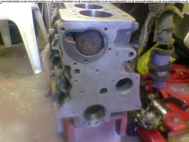

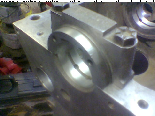

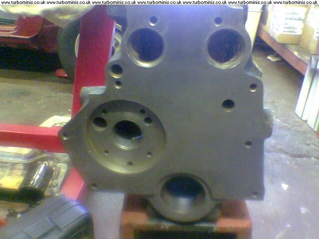

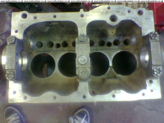

not sure what spec i'll got with it but at the moment, i'll just clean and assess & measure the parts i do actually have & pop a pic or two up! i'm considering the idea of undercrown oil jets, but i think i'd need help doing that to be honest!!! this project is defo nothing not like the 998turbo build ya'll be glad to know *happy* recommendations & advice always accepted, so to start....my bare block
all i've done is take the core plugs & gallery plugs out also the little things that prevent the main caps shuffling! are they main cap dowls?
i left it overnight in degreaser, jetwashed the block, then i put corks in the gallery plug holes & any oil-way holes but not before filling the oil gallerys with degreaser, 5 hours later i took them out & jetwashed the oil-ways, they are really really clean! :) then i used some "clarke" rust convertor down the oilways & jetwshed it out again, well........i've washed the block around 10 times in all, the clarke rust convertor is basicly a light acid & done a great job!
oh yeah, i knocked the oil gallery plugs out with an old mini bonnet stay, i hit tip to make it closer to the oil gallery plug size, hey presto, 4 light hits & they were out! jobs a gud-un!
1st job on the list is to get the crank sorted where needed! the mains checked for roundness & bearings to match, thats my starting point anyway! i wont update this verry often but it'll be consistant

Block looks good mate, Itll go quick with the 998 gearbox on. Kindve what im doing at the mo with a 1275. Doing simple mods though like threading galleries, and shotblastin outside centremain....etc.
good luck mate.

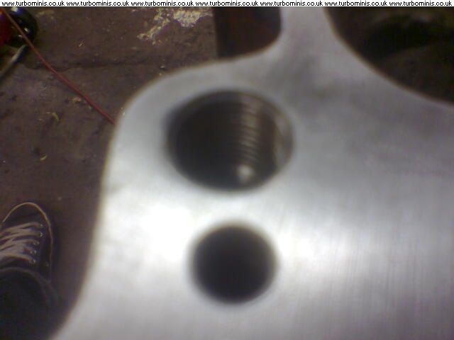

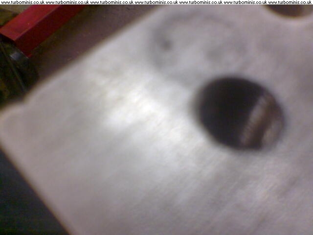

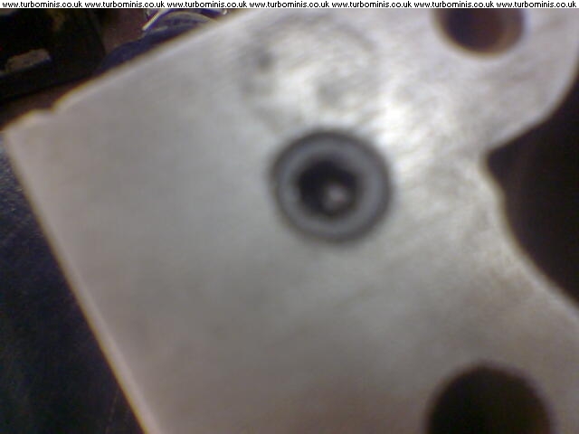

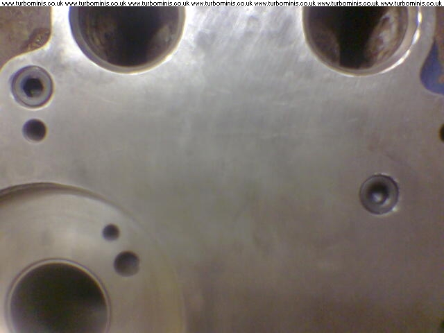

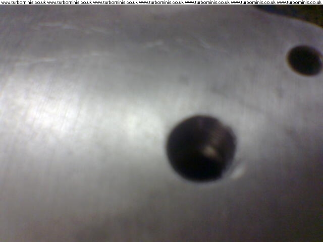

done my threaded gallery plugs today & i have to give a big "thanks" to Benross racing for lending me some taps & sorting me out with a few plugs for the job & some advice to do it! i'm not paying out for this sort of work again, heres some progress, excuse the crappy pics
i'm going to run a countersink bit on the edges of each of the holes to tidy them up, only lightly but i'm dead happy with the result & the threads are far better than what i've paid to be done previously, right back to te vizard book for a read of more stuff i can do at home with minimal tools *happy* cheers

super stuff a pleasure to help
i hope you FULLY removed the brass plugs from them 2 x 1/8" BSP ones
and they are clear,you can poke them straight through the port drilling with some wire or whatever
good stuff keep us posted

cheerrs steve, yep i got them 1/8" buggers out a treat, as you say some coat hanger wire helped! had to use an 8mm drill bit for the smaller bungs as i did'nt have an 8.5mm jobbie, a but of careful wiggling of the drill bit helped *tongue* it tapped in super smooth!!! cut the cast iron like butter!
