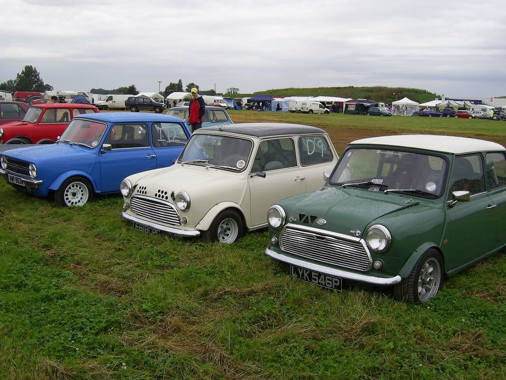

This is the mini at avon before everything began.
it was a 100% steel shell with only carpet, sound deadening etc removed inside but with a six point cage.
estimated weight was around 700kg according to the MOT station brake tester machine thing.
(the one on the right)

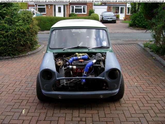

First off cutting the front end off, including A-panels:

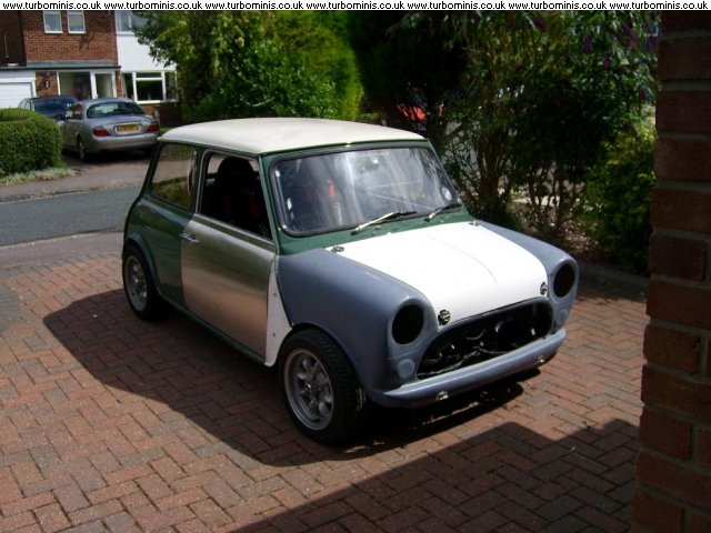

and then fitting the front end (and the inevitable cutting/filing/shaping/swearing):
weight saving here was not as much as i thought it might have been.
Removed:
Front end with a panels - 13.2kg
bonnet - 6kg
Added:
fibreglass front - 3.8
brace bars - 2.8kg (2 x 1.4kg)
fibreglass bonnet - 2kg

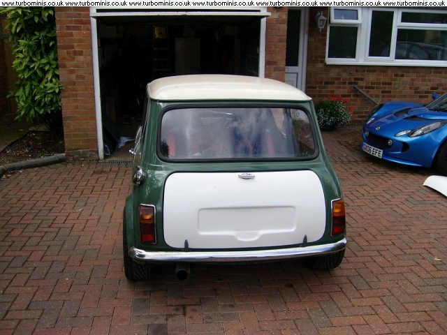

next was the fitment of a fibreglass bootlid:
this was quite an easy fitment process so any weight save gained here is quite quick mod and doesnt cost that much (except painting obviously but that will come later over the winter!).
Removed:
steel bootlid - 4.6kg
Added:
fibreglass bootlid - 1.2kg

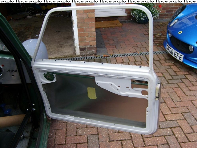

next area to look at was the doors. my doors had seen better days (bottom was badly rotted and would have needed quite considerable repair as well as reskinning) so i decided to bite the bullet and fork out for some aluminium skinned 'streetfighter' doors from the mini door company.
im really impressed by these and the service was really good, from a genuinely nice guy.
doors fitted:
i still need to fit the polycarb sliding windows to these before the weekend but that shouldnt be too much of a job.
weight removed:
complete door - 20.6 (each)
consisting of: bare door - 10.2kg, window mech - 1.8kg, glass 4.4kg, door card (aluminium home made jobs) - 2.2kg.
new doors:
bare door - 5.6kg
i will weigh the perspex and channels etc tomorrow.

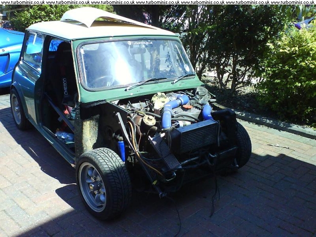

and finally i bought a big sheet of polycarbonate from a plastics company and cut out the two rear quarter windows and rear screen.
removed:
rear quarter windows - 2.8kg (each)
rear screen - 4kg
added:
polycarbonate rear quarters - 1kg (each)
rear poly screen - 1.6kg
so after all that, so far i have saved 55.6kg (take away whatever the sliding windows for the doors weigh).
there is certainly more to come in the next couple of days but this will pretty much involve taking out things that arent needed like the passenger seat!
