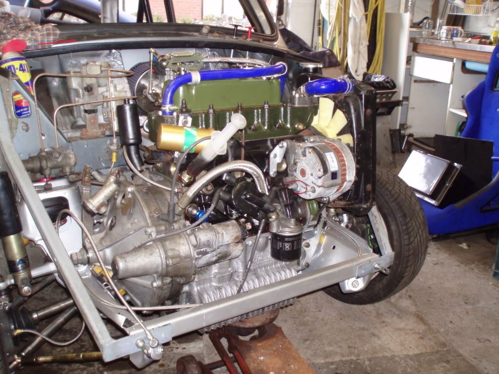

The original plan was to keep it rough, cheap and cheerful, keep it on the road and improve on it as and when things break, which they did, when the flywheel fell off in late 2004...
Due to waiting on parts, next to no progress has been made in the last 2 years, but it has given me chance to take nearly every nut and bolt off, give it a polish or lick of paint, spend a small fortune on bits i dont really need (bloody ebay!)
Anyway, finally got all the bits for the engine, its a 1380, 12:1 cr, 649 cam, usual race bits, sc everything, jkd lsd, 3.9 cw etc

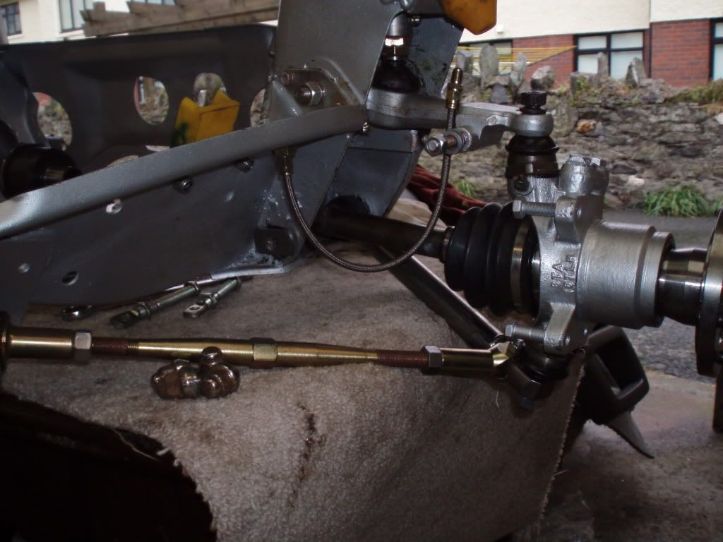

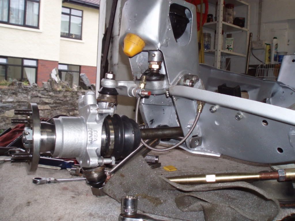

Whilst waiting on parts, fully refurbed the subframe with a few nice bits and bobs:
Just need a few bits and bobs finishing, I didnt chamfer the spacers Ive used on the delicious bottom arms (cheers fastcarl), so they are restricting the rose joints movement, only a 5 min job.
Has anyone used those poly bumpstops? they seem awfully hard..

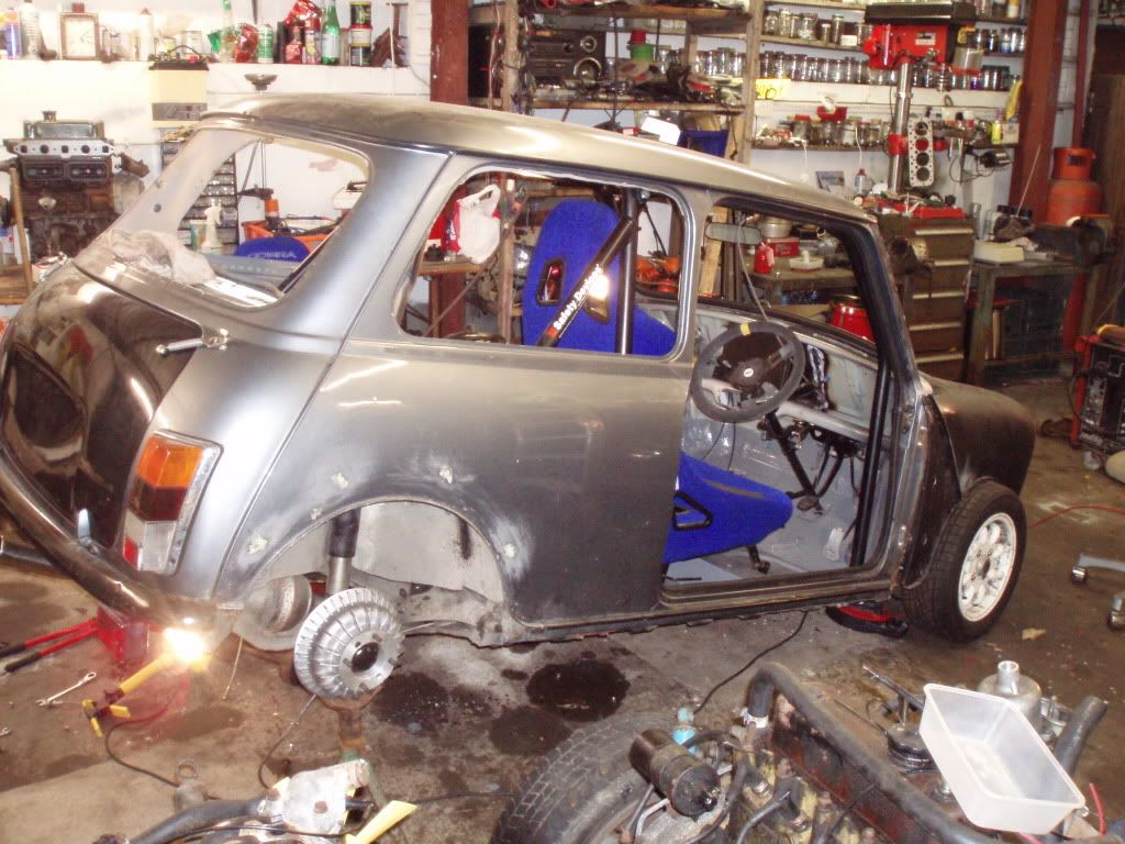

The shell needs a pair of doors (tempted by the street fighter ones after seeing nics) and a cheapo respray (groan...) gonna have it tweed grey with a diamond white roof.

I just hope you've strengthened the tie bar mounts!
Not particularly, Ive added a bolt, tieing the inner bit to the outer bit (if you know what I mean) on each side
ive seen/read about people adding gussets either side, but is that really necessary?

On 19th of Aug, 2007 at 11:30pm joeybaby83 said:
YES!
Thus just happened to me on a road car...
Jeepers, thats broke along the hole I put the bolt through.
Will go mad with the welder next weekend
Vegard,
I spotted that pic when you posted it on another forum,
I think i'll be modding my nicley welded subframe shortly!!!
So will I, on ALL subframes from today on.

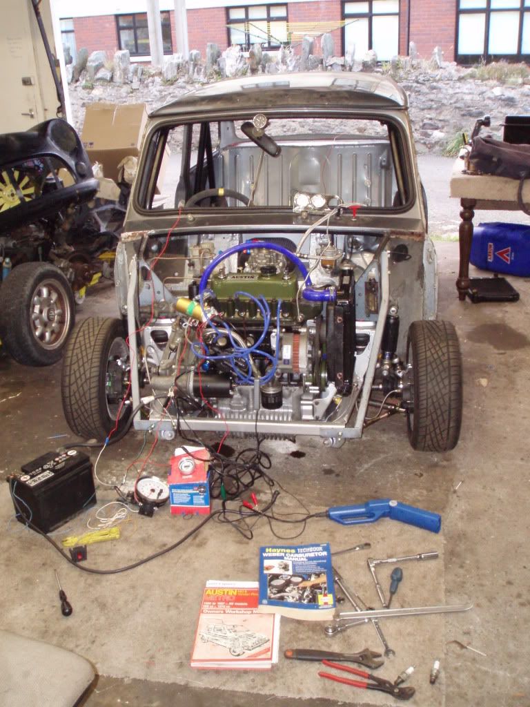

So close to startup today, pretty sure tomorrow is the big day, a bit nervous haha
Spent most of the day putting the fan belt on, its a bit of a mission with the trigger wheel in place (fucking nightmare)

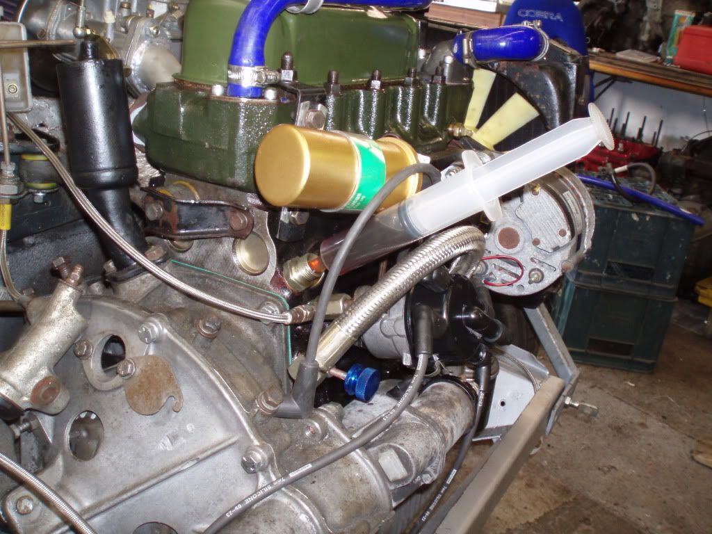

Used an old battery with jump leads on the starter, the battery died off whilst cranking, but was getting about 9 psi on a low battery (with plugs out) which seems ok
Found a great way to prime the pump before cranking over,
tried jacking a wheel up, and turning it backwards in 4th, but ended up having to drop it down and push the car back as the LSD seems to not like letting the wheel move once off the ground...
so tomorrow ill wire in the fuel pump, set the reg to 3psi and fingers crossed ill get some life out of her
I was lucky with the weber box, the air filter fits, but only just, i dont know how its so far off, im a measure twice and cut once person, so a little annoyed about that.
Gonna read up tonight on adjusting the weber for tickover etc, if anyone has any tips etc id much appreciate them tonight *wink* Never used a dcoe before

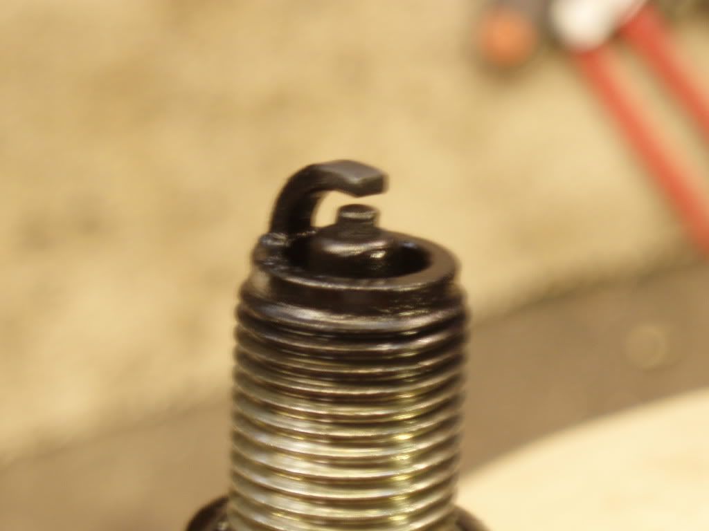

Bedded the cam in, held 3000rpm for 20 mins or so by winding out the throttle stop, held a constant 150F water temp and 70psi oil pressure the whole time, but the wideband showed 15:1 which didnt thrill me...is that ok?
Oddly (i thought) the plugs were a little black, probably just a bit of oil being sucked through, but the engines not breathing at all(?)...ill post a pic later

Joey, where is your lambda sensor fitted? If it's just stuffed up the tailpipe it could be giving you a false reading.
Assuming for now that thye reading is correct I would suggest you use some richer idle jets as these control both idle and progression up to around 3,000 rpm. I would suggest 55f8's as a start and set the idle mixture screws to 1.5 turns open.
It would be helpful if you could post up all your carb settings.
I think you will find your timing will come back to a sensible figure once you have the carb idle circuit set reasonably accuratly.
you should be able to achieve a 1,000 to 1,100 rpm idle speed with a reasonable progression despite the cam and CR.
once you have the idle somewhere near you can alter the progression by varying the idle jet fx number after the 55 to make the progression richer or leaner. One point to remember is that the fx numbers bear no logical relationship to one another.
The other option, bearing in mind you may not have access to a range of idle jets, is to buy a set of micro drills to alter the jets. The fx number refers to the size of the air bleed hole in the side of the idle jet.
The idle mixture screw should not be open more than 1.5 turns if it is you will need to swap the idle jet up a size but 55 should be a good starting point.
I cannot emphasise enough how important the idle/progression adjustment is, if done correctly it will make the car so much more driveable.
When checking the progression do not floor the pedal just move it very slowly and this will stop the accelerator pump circuit from effecting the correct readings.
if it cuts out lean solder up the air hole and drill smaller, if it bogs down rich open it up.
Hope this helps and when you get round to setting the accelerator pump circuit and main circuit give me a shout.
