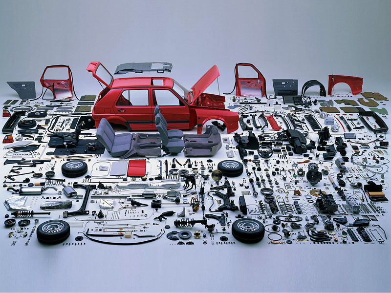

dang that is light....
so with carbon A-panel's frontend boot doors and roof
that'd be no mor than 120kg's?
so how does these fat things weigh so much then?

Remember this pic...
sturgeo
857 Posts
Member #: 1778
Northants
Hmmm, someone needs to do a pic like that with a mini
hahaha thats what my bedroom looks like *happy*
edit, what engine is that k series?
