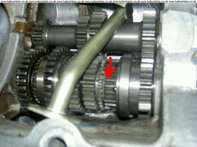

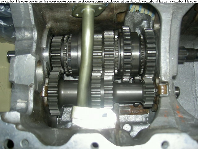

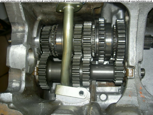

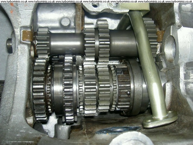

Im just been building a straight cut box.
But when i put the laygear in, it dont seem to be in line with the other gears. ?
what have i done wrong ?

well before you p[anick can you select all gear when turning selector through all bell crank levers if you cant then 3rd 4th gear syncro is wrong way round.
after checking this tighten up each nut to 15o ft lb then re check.
but other than that every thing looks ok.
but 4 th syncro does look arse about face but need to check as i am bloody tied after a hectic days fishing.

Well tried changing gears, and this happend ?
http://www.turbominis.co.uk/_photos/random...os/683/4011.jpg
Shit Happen's
Well, I don't think that anything is wrong.
Once you have fitted the main bearing retainer with shims, it will probably shift the whole assembly so that the gears line up.
However, your first motion shaft bearing may not be fully home.
Make sure that all the detent balls in the 3/4 hub are there as they look perilously close to falling out in that last picture.

Think ive done something wrong. so should them detent balls be seen like that then ?
Shit Happen's
Nope.
Is it not too difficult to pull it apart, start a fresh and put it all back together following the book to the nth degree?
I think you will have to do this anyway
That way you can see if there is something wrong or not and you are a little clearer on how it all goes togther.
Personaly i dont think that it is right, i wouldnt be happy with it, and I would be doing the above just to satisfy my curiosity.
best way of learning if you ask me, just make sure you shim up the laygear correclty
Might be an issue with 3rd/4th syncro hub (rather than the selector hub), is it installed the correct way round? This might cause the main shaft to sit further away from the first motion shaft, but bind on fourth gear baulk ring??

Yep, you've installed the 3/4 synchro hub the wrong way round on the mainshaft.
I made this mistake many years ago the first time I rebuilt the gearbox on my class 1 junior autograss car.
You'll never do it again, it needs to come to bits though now.

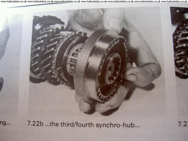

Right then. i know what u guys mean now by 3rd/4 hub.
Found my old mini book, which tells me in the pic below :)
http://www.turbominis.co.uk/_photos/random...os/683/4012.jpg
this pic here, http://www.turbominis.co.uk/_photos/random...os/683/4013.jpg shows the sleeve part is the right way round,even though i did try change gear and it come off ?
But where the arrow is, is it this thats got to be the other way round, as one end looks different then the other end on my old part. but like i said, the sleeve part looks right way round.
someone put me out my mind please :)

Everything was ok... the 3rd/4 hub wasnt the wrong way at all... spoke with hogster, and he said the gears could be jammed.. and they were..
so just triped it. now starting again lol
