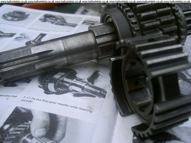

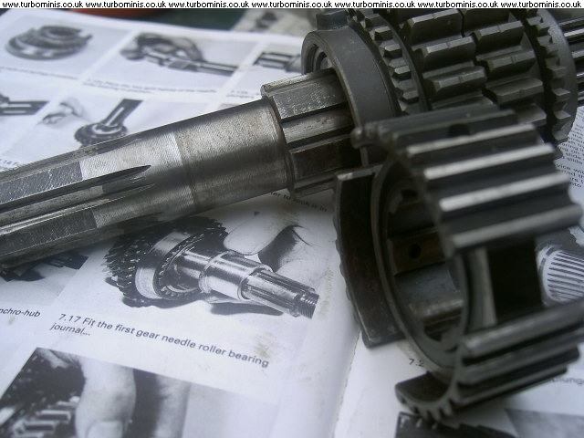

Bonjour....rebuilding my box again. should this hub be pround end towards the pinion, or the less pround end towards the pinion.?
The other hub shows me in the book, but this one dont... cheers :)
http://www.turbominis.co.uk/_photos/random...os/718/4014.jpg
http://www.turbominis.co.uk/_photos/random...os/718/4015.jpg

Found out from hogster.
that its the less pround part towards the pinion.
for those who might ever come across this when building...
Cheers lads..
