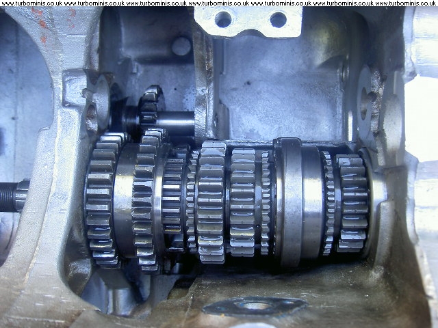

Natural..
http://www.turbominis.co.uk/_photos/random...os/683/4016.jpg

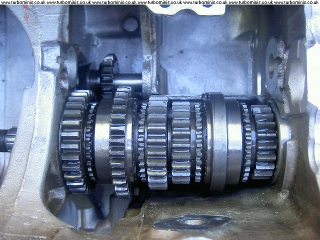

1st Gear..
http://www.turbominis.co.uk/_photos/random...os/683/4017.jpg

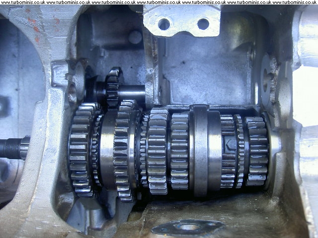

2nd..
http://www.turbominis.co.uk/_photos/random...os/683/4018.jpg

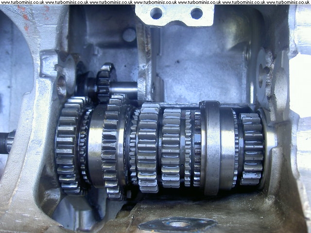

3rd..
http://www.turbominis.co.uk/_photos/random...os/683/4019.jpg

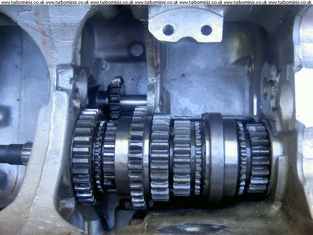

4th..
http://www.turbominis.co.uk/_photos/random...os/683/4020.jpg
If you look at 4th. isn't the sleeve meant to go futher to the right. ive pushed it in as far as i can go, with my hand of course. but wont go any further ?
Any ideas.

it must go further to the right yes, there is something wrong, or you have not managed to get it fully engaged.

Well i checked and checked again when rebuilding it. before i put the gears in, everything was ok. would it be very hard to put it in 4th by hand. i pushed it hard to engage it,but wont go further.. if something's wrong, what could it be i wander.... ...

stick something (screwdriver or whatever) in the hole in the shifter thingy (sorry I dont know the name) that comes out of the diff. That will give you a bit more leverage to twist/push/pull.

just hit it, not very hard with a wood hammer :) and it went right over, then ping, the bearing flew out.it shouldn't go over that far should it... or can that happen ?

You know the 3rd and 4th hub thing, it has little 3 detent bearings and springs ... just got em all back it :) anyway. so for some reason, it pushed the hub to far over ? maybe when connected to the rod and gear change, it might not do this ? any idea.

Update.. since i bashed it with the wood hammer. it seems ok now.. but you can push it too far if your not careful.
which makes the bearing pop out.
so a bit of brute helped *tongue*

The 3 balls that sit ontop of the Synchro unit springs, flew out..
That better buddie *wink*
All sorted now thank f*ck..

I just placed the springs in, then rested the BALLS *tongue* on the edges, then with 3 fingers, pushed the balls in slightley, then pushed the hole hub in the sleeve.. was easy when u know how.. :)
