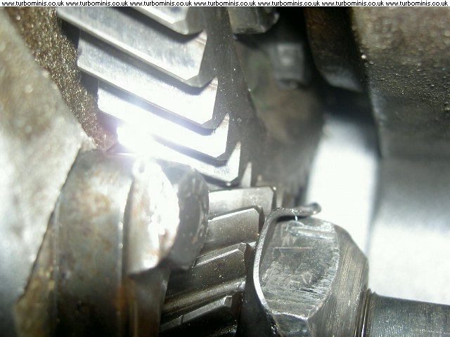

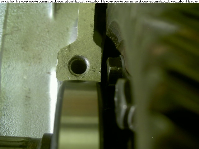

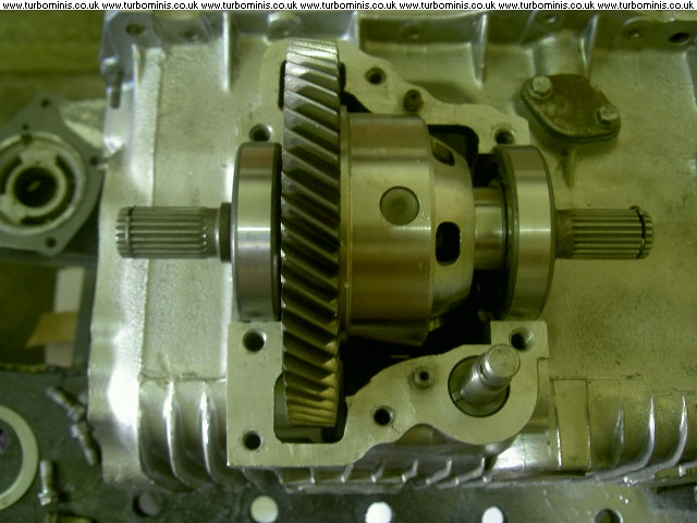

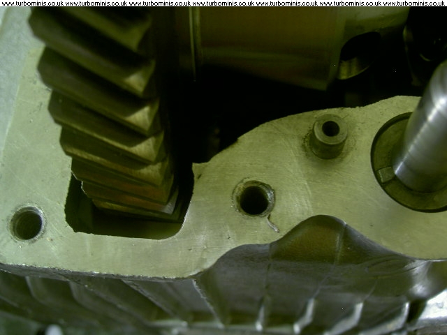

Ive just shimed my diff.
I pulled the crownwheel and diff to the right (clutch side) as i can. then placed both side covers on. then toqued them up. then checked the gap, which was 37 thou. so i then placed 36 thou of shims.
Doe's 37 thou gap sound about right to u guys.
And doe's everything in pics look ok to u.
As it's my first build etc, i just want t make sure ive got it spot on.
Maybe someone could say, that dont look right in the pics etc..
So i just want to me 100% sure.
But hope you say it look spot on.
Not being fussy, just being cautious *wink*
Cheers.

Impossible to say from pictures, but that is not wrong.

if the gap is 37 thou including the gaskets then yes 36 thou worth of shims is correct
visually nothing appears out of the ordinary imo
