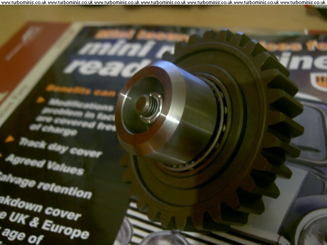

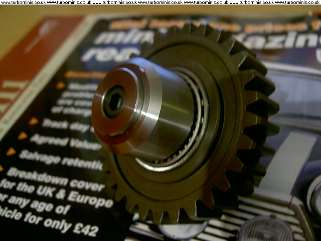

What side goes into the gearbox casing first.
Picture 1, or pic 2 ?
Maybe silly Question, maybe not...
Or maybe it dont matter *tongue*
(1) http://www.turbominis.co.uk/_photos/random...os/718/4055.jpg
(2) http://www.turbominis.co.uk/_photos/random...os/718/4056.jpg

doesnt realy matter mate but i would put the side with the nut in the trans case.
and as for your email the box should turn freely but dont worry to much that yours is a bit stiff it just need plenty of oil round the baulk rings aas they have a tendancy to grab at the cones when dry making it lock up or become stiff.

Work out which direction the gear rotates then fit it so that if it had any influence on the nut it would be to tighten it rather than loosen it.
That is probably the direction hogster said but not having seen the tread it's best to check yourself.
I have heard tales of these things undoing themselves and wrecking the transfer gear set and box cases. I'd be putting a decnt quality thread lot in there, won't need anything to strong though .... Loctite 242 should so the job but make sure the threads are good and clean / oil free first.

Hmmm that would be scary.. and gutting.. ok so should i use a locking nut ontop off the one thats already on there ?, and what kind on nut.. and as for the Loctite. would this do it ?

That loctite would be ok for the job.
I'd put on a lock nut even though it's a nyloc as they can let go with heat and oil. Make sure it doesn't come past the end of the threads on the bolt or else you might run into fitment problems on assembly.
Normally if your going to fit a lock nut you want it to be of equal or greater thickness of the first nut but in that instance, as the first is a nyloc, you should be fine.
By the way have spoken to one of the UKs premier A sseries builders today and he tells me he has seen more of those come undone than stay tight!! He always uses two nuts and thread lock on his rather than a nyloc.
