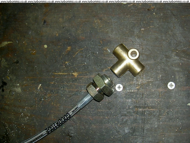

Right im setting up the front brakes that uses just the brake Master cylinder, no servo of course
I got this BRAKE UNION 3 WAY from minispares. http://www.minispares.com/Product.aspx?pid=35296
Between the union and brake hose, (pic below) whats meant to Go inbetween them ? this is on the drivers side.
http://www.turbominis.co.uk/_photos/random...os/718/4057.jpg
The left hand side dont use one of course, but that sides all done..
Just not sure on the drivers side, ?
Or maybe ive got the wrong part ?
Any help would be great.
Shit Happen's
Yes, wrong bit. you need this
http://www.minispares.com/Product.aspx?pid=36668
You also need the bolt that goes through it, but I can't see it on the website, you have to phone and ask

I see what you mean.. durr.. lol
Cheers will :)
