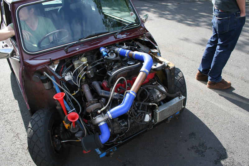

Gents, i finally have the 998 turbo on the road. Just in time for the North West mini club RR shootout last saturday. It was touch and go if i could get it ready, but the deadline really spurred me on, it was MOT'd and taxed at 4pm on the friday night before the shootout.
Its far from finished development wise. and it wasn't set up but i though i'd let Rob at mini sport give it death anyway *wink*
It got a healthy 81 BHp and 65Lbf @ 8PSI
I have since fitted a bleed valve to have a little tickle with her. but the standard 998 clutch is slipping at 1 BAR. So it set it back to 8PSI. until i can understand which clutch kit to go for?!?!
Can anyone advise on the best kit for cheap dough?
P.S. the RR shooutout is in decembers miniworld.
998 turbo in progress.... DONE..........KNACKERED LOL

That looks like a real neat installation. good work.
external wastgate?..looks cool

what's the rest of the spec then, is it on another thread somewhere? That's good figures with little setup, especially with no intercooler.
That's a good point!
Why is there no intercooler! there's plenty of room under that removable front end!
intercoolers a must!

The spec is 998 A+ block
pocketed at uni.
Pistons are standard press pin. 5cc Dish on lathe at uni.
MG metro cam, simplex chain.
Standard oil pump (think this needs uprating)
12g940 ported head.
Standard metro turbo carb, inlet, etc
Custom made manifold and down pipe to bring IHI RHB5 turbo over flywheel housing. It aint pretty (done on MIG) but it works.

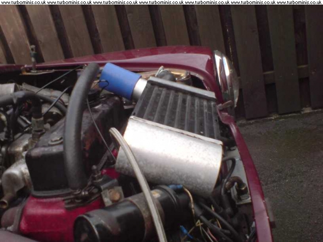

right i been messing around with intercooler positions today. I have an idea of putting a modified Mk2 RST one as per the pics.
Will have to weld it up at uni this week.
It will clear the bonnet, but will it flow enough? I intended to put it at the front next to the oil cooler, but the bend from the turbo to the IC would be too tight.

I would position it next to the oil cooler up front. If it's too tight, move the oil cooler to a different location and put the intercooler there.
Yeah I'd fit it next to the oil cooler, right in the air flow. *wink*
