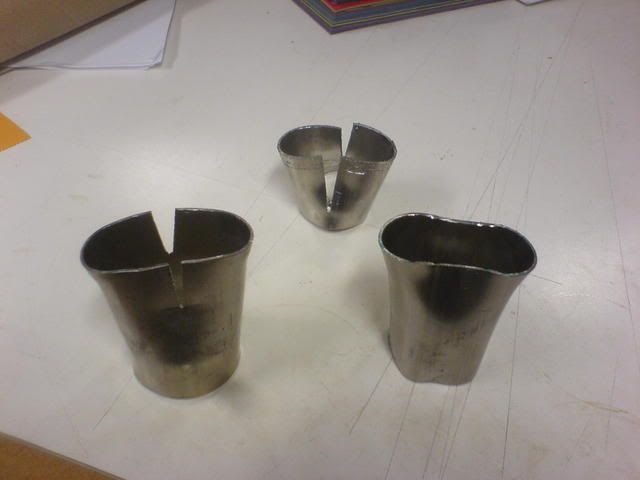

Aborted test runs trying a few things

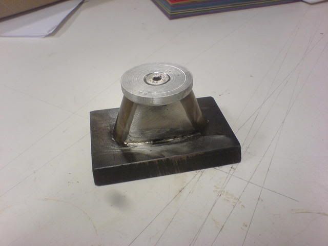

Forming tool

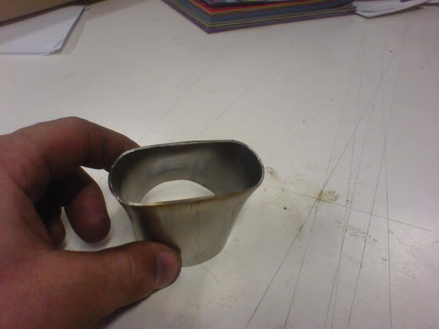

Finished

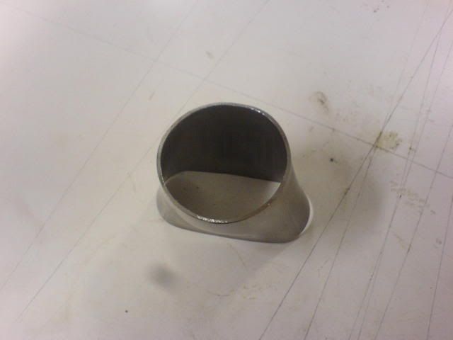

Most interesting thing is how well the material forms, it is 304 stainless.
Tom, Is it actually 'stretching' the material, or simply 'changing the shape' of the tube? ie - if you measure the circumfrence at each end is it still the same?
It does stretch it slightly, not much though, I just thought it is interesting how neatly it forms them.
Difficult job well done.
Did he use any heat?
Presumably he used a press.

how was the tool made?
fab
