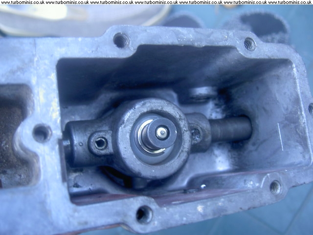

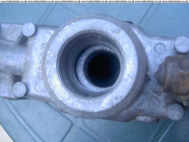

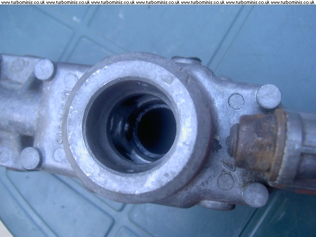

Which way round does this go for the short shift gear stick to go Into.
1.
http://www.turbominis.co.uk/_photos/random...os/683/4191.jpg
Or 2.
http://www.turbominis.co.uk/_photos/random...os/683/4192.jpg
And you know that lever on the gear stick, which u pull up to make it go into reverse
http://www.turbominis.co.uk/_photos/random...os/683/4193.jpg
Well as u pull it up, what makes it work. as from the pic above, it dont seem to do anything ?
can someone help us out please
Cheers :)

First question, it goes lower down like in pic no 2.
Second question, on the plate that screws on the bottom there should be a bit of metal that stics up to prevent the stic going into reverse.
Oh right.. so as u pull it up, it helps to selected reverse.
Cool.. thanks for that :)
Shit Happen's
as you pull it up it will clear the bit on the bottom plate so reverse can be selected.
